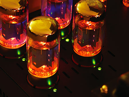

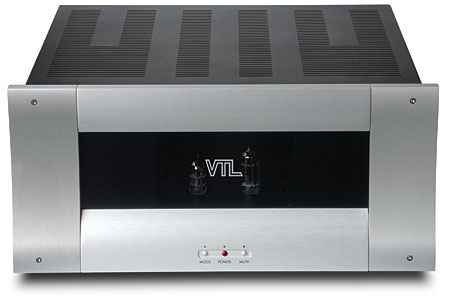

"In the VTL MB-450 Series II Signature, the rack-mount handles and dark industrial look of the original MB300 and MB-450 (footnote 1) are replaced by a thick, elegantly handsome, curvaceous faceplate of brushed aluminum that frames a dark glass panel, through which glow the input and driver tubes. Three small buttons and accompanying LEDs select Mode, Power, and Mute. And that's it for the front panel.
On the rear panel are the main On/Off switch, a set of speaker binding posts, RCA and XLR inputs, a switch to select balanced or single-ended operation (I used the single-ended), a 20-amp IEC jack, five fuse holders, and a trigger connector for remote power-up via another source, such as a preamplifier. Much like the original VTL 300, from which the MB-300 and MB-450 are derived, the tube complement comprises eight 6550C output tubes, and one each 12AT7 and 12BH7 tube for the input and driver stages.
The MB-450 Series II incorporates many of the technological advances found in VTL's flagship monoblock, the 800W Siegfried Reference. These include "smart tube," logic-controlled auto-biasing circuitry, which continually checks and optimizes each tube's performance while providing a series of fault-sensing diagnostics for each tube via a series of LEDs. VTL maintains that the auto-bias circuit doesn't affect the sound quality because it's not part of the signal path, and monitors and biases the tubes only when music isn't being played.
