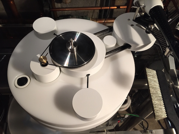

The round base, about the same diameter as the platter, is a smoothly finished wafer of POM on which is mounted a raised On/Off rocker switch and an AC-synchronous motor, the latter housed in a structure tall enough to protrude through a hole in the next layer of POM, which rests on the base via three elastomer feet.
Mounted on this POM layer are three satiny aluminum discs—two large, one small—that surround a much larger central disc, into which is fitted the phosphor-bronze spindle bearing. This central disc is suspended from the second base via a pair of small-diameter, "unidirectional" carbon-fiber rods, creating a cantilevered leaf-spring–like structure.
The aluminum arm-mounting platform is itself cantilevered off of the base via three more carbon-fiber tubes: two far thicker ones sustained by the bearing support disc, and a thinner one held by the smallest of the three surrounding aluminum discs, which is the disc closest to the armboard. Though both of these cantilevered structures are extremely stiff, they flex when pressed . . . . .

As you can see, the motor’s close proximity to the sub-platter and the “O”-ring drive is in many ways similar to Rega’s basic drive concept—something I didn’t take note of in the original review—though W-B’s execution appears more costly than that of the top Rega I’ve examined (the RP8) and the main bearing is (I think) of a larger diameter. The Circle 25, like its predecessor uses a two step brass pulley.

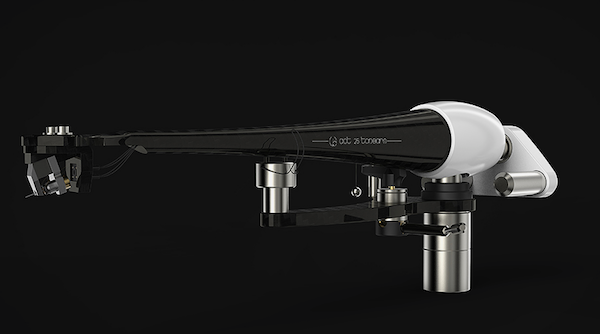

The A.C.T. 25, which has an effective length of 233mm and an overhang of 18mm (in other words its actual length is 215mm or around 8.5 inches) 15% lighter than the 0.5, with no loss in stiffness or damping claims Wilson-Benesch. I’m not sure why lighter is necessarily better in a tone arm. It all depends upon the mass and compliance of the cartridge you plan on using it with, of course.
W-B says the arm uses the same “kinematic” bearing as the original which it describes thusly:
“The kinematic bearing features, three x 1mm carbon-chrome ball bearings, which are held captive in a brass ball cap located at the end of the arm stem. A fourth ball is retained by a brass mount located in the egg shaped housing at the end of the tonearm. The shape of the eggshell derives stiffness and strength through its geometric form. When mated the fourth ball is held in a high pressure triangulated frame of reference ensuring that the centre of movement can never change regardless of the age of the system or the ambient temperature. In theory the contact surface is a single molecule.”

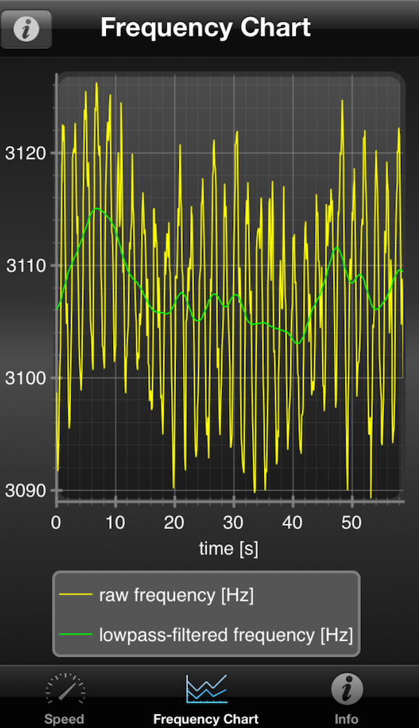

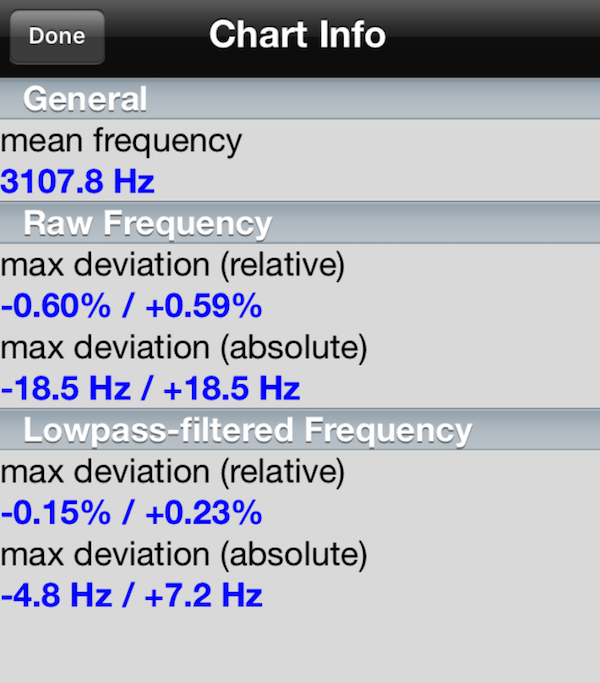

When I finally got around to measuring the Circle 25’s speed accuracy and consistency using the Feickert Platter Speed app, I was surprised to find that the ‘table ran about 1.34% slow. In other words a 3150Hz tone was reproduced as 3107.8. That translates to about 32.8 rather than 33.33. . . . . .
Mr Spock
demokratischer - sektor
18.455
50.601
More troubling though and frankly inexplicable was the rather poor speed consistency measured by the Feickert software. The green line shows the filtered frequency. Ideally it should be a straight line. It never is, but it usually shows a slight ripple. This is far worse than normal.
I had a few new replacement “O”-rings and so substituted those but got the same results. I cleaned the pulley and inner hub surface and made sure that the upper POM plinth was correctly seated so that the distance was correct from the pulley to the inner hub. I did everything I could to improve the speed consistency and I made sure to do all of the measurements with the felt mat in place in case the heavier graphite platter was causing a problem.
None of that made any difference, nor did trying the Falcon PSU. It brought the speed up to 33.3 (set to 33.5) but speed accuracy was made worse, perhaps because it is not compatible with whatever internal power supply W-B uses. So when the ‘table goes back to the importer I hope Sound Organization will shed some light on this because I can’t imagine the performance is typical of the ‘table. I know this particular ‘table has been “out on the road” so perhaps something not obvious and not visible caused the measured issues.
On the other hand, since nothing seemed obviously wrong I felt obliged to finish and publish the review. Why didn’t I hear something wrong? For one thing the speed error is minor even though it appears gross. Only someone with perfect pitch (not me) would hear that the ‘table was running somewhat slow.
As for the speed inconsistency, that may account for the overall smooth sound, lacking in transient “snap” and precision. I would have to hear another sample producing greater speed accuracy and consistency to know.
