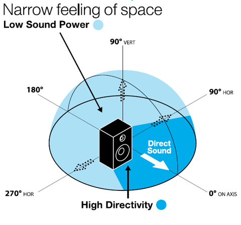

New research by CEA, the world’s biggest consumer electronics industry authority, shows that much general listening happens ‘off-axis’, which means that consumers’ listening experience is seriously impaired by most speakers’ inability to deliver their optimal sound throughout an acoustic space. To hear most speakers as they are intended to sound requires the listener sitting in an ‘on-axis’ position – in other words, in a very narrow ‘sweet spot’ that restricts consumers’ movement, family comfort, sociability, and which even limits the number of people who can enjoy music together at the same time.

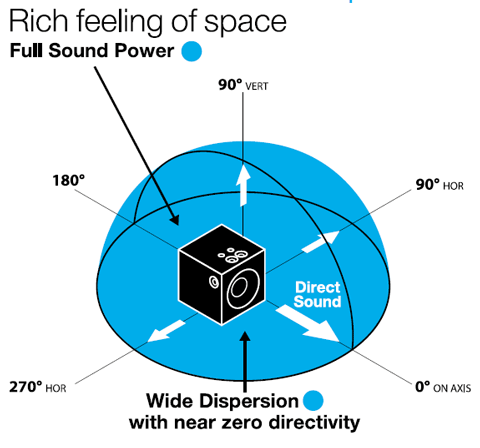

Natural Spherical Omni-directional Sound with Balanced Vertical and Horizontal response
WiSound™ speakers are equipped with balanced Up- and Side-firing drivers for mid and high frequencies. WiSound™ patented Flat In-Room Speaker Response technology uses balanced driver pairs instead of traditional front firing drivers.
This way, we achieve a flat, smooth response with both Direct Sound AND spherical Sound Power in every direction throughout the room.
Thus smooth reflections and natural sound without colorations are formed. This patented design results in Flat (±1dB) In-Room Response, measured according the ANSI/CEA-2034 standard Method of Measurement for In-Home Loudspeakers.
Vertical 360 degrees radiation is balanced and equal with the horizontal 360 radiated sound power.
Balanced: Sound Power & Direct Sound
Balanced Room and Speaker interaction

Spherical Response
Natural balanced sound power throughout a wide listening area
Balanced Sound Power and Listening Window response is the ideal response of a good speaker, with both curves being flat and having a similar shape. This is the most important and unique characteristic of our patent-pending WiSound™ Flat In-Room Responce speakers.

  1. The sound is properly balanced throughout the whole listening area; not just in the on-axis position in front of the speakers. In other words, the sweet spot, from a tight and specific area as it is with the conventional technology, widens to the dimensions of almost the entire listening area, with the instruments outlined in space, simulating live music listening conditions.
  2. The sense of space is balanced,releasing the audio experience from small listening room limitations, as the reflected sound is stronger than the direct, even in small spaces close to the speaker, but not more than what is needed for the proper sense of space
  3. The sound is perfectly natural and enjoyable, just like in live music.
Apart from the appropriate choice of drivers and their placement as described, equalization (active or passive) is being used.
Lastly, the Sound Power response curve is identical and at the same level as the On Axis response at all frequencies, in order to achieve a constant Directivity Index close to zero DI = 0, i.e. Balanced Directivity and not just very high constant directivity, as existing technology does.

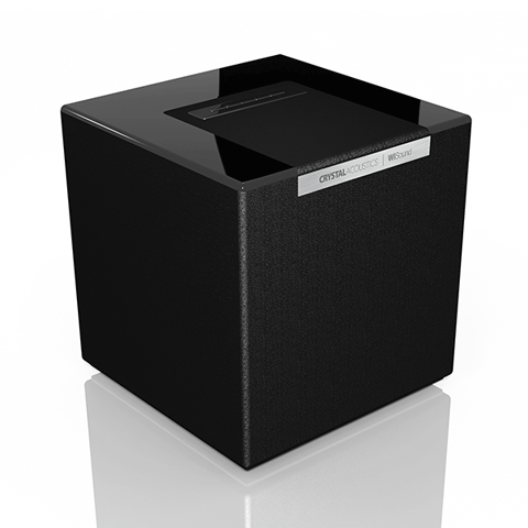

Cuby 7
Turn your desktop into a live concert hall!
• 7 Drivers with Balanced Directivity for wide sound everywhere in the room
• Ideal In-Room response
• Incredible Bass down to 35Hz
Technical Specifications
Frequency Response Smoothness (65Hz-10KHz)
±1dB
Frequency Range (-6dB)
38Hz - 27KHz
BluetoothAPTX
DSP
Yes
Class-D amplifier
Yes
Remote control
Yes
Amplifier Power Output
2 x 25W + 50W
Input Voltage
100V/240V, 50/60Hz
Standby Power Consumption
<0.5W
USB Charger
500mA
WiFi
Optional
Drivers
3/4 inch tweeter
2
2 inch midrange
4
6.5 inch subwoofer
Inputs
Line in Auxiliary
3.5mm Μini Jack
2 x RCA
Digital
Optical
General Features
Height (mm)
235
Width (mm)
235
Depth (mm)
235
Enclosure material
Wood MDF
Grille material
Textile
Flat In-Room Speaker Responce speaker, for your desktop, your living room, your every room. A completely innovating and original speaker, with unprecedentedly perfect sound that will transform your desktop to a real live stage!
