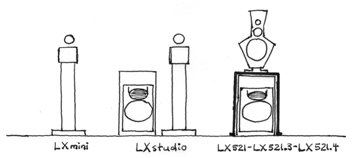

"In 2015 I plan to extend the LX speaker family from the analog LX521 and the digital LXmini by adding three new members: LXstudio, LX521.3 and LX521.4. This will provide an upgrade path for LXmini builders to LX521 levels and be a revisit of the LX521 using DSP for equalization and crossovers.
For the LXstudio I add to the LXmini the open-baffle woofers of the LX521 and use the miniDSP 4x10Hd for xo/eq. A prototype is already running and impresses me with its fast dynamics, 3D rendering and expected extension of bass. The 4-piece system provides greater flexibility in room placement than the LX521.
For the LX521.3 and LX521.4 systems I plan to start out from acoustic measurements again, expecting more options in driver equalization from a DSP unit than was practical with the ASP. The LX521.3 will be a 3-way active system including the existing passive crossover, while the LX521.4 will be a 4-way active system and require an additional pair of power amplifiers.
Those are my plans. Let's hear what materializes.

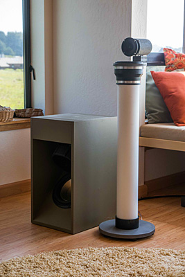

- A 2-way loudspeaker that can be built for around $1000 including miniDSP 2x4 equalizer/crossover and 4 power amplifiers in the 50 W to 200 W range. The speaker has a unique polar pattern, starting out as omni at low frequencies from the infinite transmission line woofer, going through a cardioid region around the 800 Hz crossover to an unbaffled, full range driver with dipolar behavior. Due to the low crossover frequency and acoustically close proximity of drivers the polar pattern is identical in vertical and horizontal directions, like in a coaxial design, but it has much wider dispersion at higher frequencies. The frequency range extends from 45 Hz to 20 kHz with 12 dB/octave roll-off at the low end.
LXmini Construction Plans: $105
LXstudio - A 3-way loudspeaker that combines the LXmini with the dipole woofers of the LX521. It requires addition of two 200 W or four 50 W power amplifiers and a miniDSP 4x10HD unit to form a system that covers the 20 Hz to 20 kHz frequency range with excellent clarity and dynamism. With an LR2 crossover at a low 60 Hz the woofers can be placed against the side walls of a room and the LXmini used as near-field monitors. Path length differences to the listener can be compensated for in the DSP unit. Dipole woofers have the advantage of less room mode excitation, which matters even in a highly damped recording/mixing studio. (The design is in the final evaluation phase.)
LXmini Construction Plans: $105 + LXstudio Conversion Plans: $55 (available late April)
LX521.4 - A 4-way loudspeaker, designed as full-range dipole, for flat on-axis and off-axis response in the horizontal plane and frontal hemisphere. It requires between 8 to 10 power amplifiers of 50 W to 200 W and a miniDSP 4x10HD. The speakers need breathing room of at least 1 m to the nearest large reflecting surfaces and a room with a minimum floor size of 25 sqm. (The design is in the final evaluation phase.)
LX521 Construction Plans: $155 (LX521.4 addition available to all plan owners early May without cost)

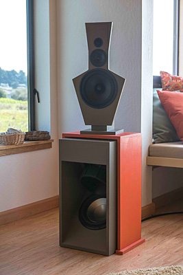

LX521.4 - The Construction Documentation is now accessible to owners of LX521 documentation for free
"LX521.4 is a 4-way loudspeaker, designed as full-range dipole, for flat on-axis and off-axis response in the horizontal plane and frontal hemisphere. It requires between 8 to 10 power amplifiers of 50 W to 200 W and a miniDSP 4x10HD. The speakers need breathing room of at least 1 m to the nearest large reflecting surfaces and a room with a minimum volume of 65 m3.
The LX521.4 eliminates the passive L&C crossover in the LX521 top baffle and brings the speaker to its logical completion. Drivers and baffle design remain unchanged. Equalization and crossovers have been redesigned from newly taken acoustic measurements for a lower listening axis.
With its clarity, imaging, high dynamics and disappearance from one's auditory illusion, the LX521.4 renders a superb recording probably as good as it gets and delivers a highly enjoyable experience. I am delighted."

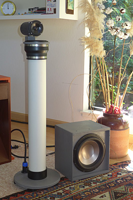

LXmini+2 Construction plans
LXmini+2 is a 3-way loudspeaker that combines the LXmini with two, compact LXsub2 dipole woofers.
It requires addition of two 50 W power amplifiers and a miniDSP 4x10HD unit to form a system that covers the 20 Hz to 20 kHz frequency range with excellent clarity and dynamism. With an LR2 crossover at a low 60 Hz the woofers can be placed against the side walls of a room and the LXmini used as near-field monitors. Path length differences to the listener can be compensated for in the DSP unit. Dipole woofers have the advantage of less room mode excitation and thus preserve articulation in bass sounds.
LXmini+2 is a speaker that is on par with the LX521.4 in terms of frequency range, clarity, imaging, sound stage size and disappearance, albeit at lower maximum sound levels and particularly in the deep bass. The system is flexible in room placement and woofer setup, providing highly satisfying and enjoyable rendering of stereo recordings.
Compared to the LXstudio the LXmini+2 has the same low frequency response but it rolls off more steeply below 20 Hz to attenuate undesired subsonic signals. Due to the compact open baffle design and the fact that only two instead of four 10" drivers are used, the acoustic output is about 10 dB less than from the LXsub4 woofer of the LXstudio. This means that the LXsub2 has to be driven 10 dB harder, i.e. the cone excursions have to be about three times larger for the same SPL as from the LXsub4. When using a 200 W/channel power amplifier this can lead to damaging excursions of the 10" driver at very low frequencies. So caution is advised. A 50 W amplifier is much safer to use and likely to clip before the driver will. But it will also not allow for maximum excursion at 60 Hz. In my system I use two channels of an AT1806 (180 W/ch) to drive the LXsub2, and start with a low volume level for playback of an unfamiliar recording, before turning up the volume and watching the driver cone for over-excursions, which also announce themselves as severe distortion. When operated with care the LXmini+2 can handle any program material at enjoyable SPL.
