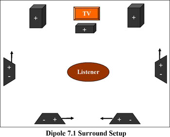

Θα πρέπει να προσέξεις και λίγο την τοποθέτηση για μην έχεις ακυρώσεις. Διάβασε παρακάτω για να καταλάβεις
Dipole surround speakers are typically labeled Left and Right so that, when you place them on the sides, the in-phase drivers are pointing towards the front of the room. This allows them to be in phase with your front speakers and avoid cancellation problems that can occur when out of phase drivers are facing each other.
If, in a 7.x setup, you decide to use another pair of dipole surround speakers in the rear, you will have to place the left speaker on the right side and the right speaker on the left side as in the diagram below. This is to avoid cancellation problem when the speakers are out of phase. If you decide to use direct radiating speakers or bipole speakers in the rear, you will not need any special consideration.
For dipole speakers, if there are arrows on the speakers they should face the front of the room for the side speakers, and toward the center of the wall for the rear speakers.
