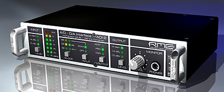

Ενδιαφέρον νέο AD/DA προδιαγραφών και ίσως και αντί-Behringer!
Ultra Audio
4.621
2.831
και
Φαίνεται ενδιαφέρον έχει και εξωτερικό τροφοδοτικό και οι πληροφορίες μου από Δανό φίλο είναι ενθουσιώδεις....
για δείτε και:
But the ADI-2 has more to offer than tremendous sound, it also gives you exciting digital connectivity. Its transformer-balanced coaxial (RCA) SPDIF I/O has switchable Channel Status to make it fully AES/EBU compatible. The optical TOSLINK I/Os can handle up to 192 kHz and also serve as ADAT I/O with up to 96 kHz sample rate. You can even use SPDIF input and ADAT output or vice versa in AD/DA mode.
The clear layout and the distinct labeling of the front panel with its functional buttons, the informative status displays, a 6 LED level meter as well as the tidy functional back panel make it easy to operate the unit right out of the box. Protective rack handles and a strain-relief for power cord and audio cables are further useful details that make the ADI-2 even more unique.
POWER TO THIS UNIT! Top
Following the 'Universal Power Supply' philosophy of RME's Digiface, Multiface, QuadMic und OctaMic, the ADI-2 comes with an external switching power supply. The unit's additional internal switching power supply has been specially designed and optimized for audio applications. It accepts any voltage from 7 to 30 V, be it AC or DC, and even runs on batteries and rechargeable batteries.

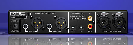

TECHNICAL SPECIFICATIONS Top
Input AD: 1/4" TRS jack and XLR via Neutrik combo jacks, servo-balanced, completely symmetrical, DC-coupled signal path
Output AD: ADAT optical or SPDIF optical, SPDIF coaxial, AES/EBU compatible
Input DA: ADAT optical or SPDIF optical, SPDIF coaxial, AES/EBU compatible
Output DA: 1/4" TRS jack and XLR, servo-balanced, DC-coupled signal path
Dynamic range AD: 110 dB RMS unweighted, 113 dBA
THD AD: < -110 dB (< 0.00032 %)
THD+N AD: < -104 dB (< 0.00063 %)
Crosstalk AD: > 110 dB
Dynamic range DA: 116 dB RMS unweighted, 119 dBA (unmuted)
THD DA: < -103 dB (< 0.0007 %)
THD+N DA: < -100 dB (< 0.001 %)
Crosstalk DA: > 110 dB
Input/Output level, 0 dBFS @ Hi Gain: +19 dBu
Input/Output level, 0 dBFS @ +4 dBu: +13 dBu
Input/Output level, 0 dBFS @ -10 dBV: +2 dBV
Sample rate internally: 32, 44.1, 48, 64, 88.2 kHz, 96 kHz, 128, 176.4, 192 kHz
Sample rate externally: 28 kHz - 200 kHz
Frequency response AD/DA, -0.1 dB: 5 Hz - 21.5 kHz (sf 48 kHz)
Frequency response AD/DA, -0.5 dB: < 5 Hz - 43.5 kHz (sf 96 kHz)
Frequency response AD/DA, -1 dB: < 5 Hz - 70 kHz (sf 192 kHz)
Accepted power supply voltage DC 8 V - 28 V, AC 8 V - 20
Dimensions 215 x 44 x 130 mm
Warranty: 2 years

Φοβερό μειονέκτημα η έλλειψη ψηφιακής εισόδου-εξόδου AES/EBU σε XLR. Χαλάει όλη την ιστορία στην κατά τα άλλα πολύ καλή (από χαρακτηριστικά), συσκευή. To AES/EBU compatible δεν μου λέει πολλά. Πολύ σημαντικό για να το ξεχάσει, (ειδικά) η RME.
