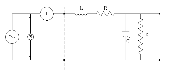

Να και ενα χρησιμο link που λεει καποια ωραια.
http://http://home.mira.net/~marcop/ciocahalf.htm
Figure 2. Equivalent circuit of a cable connected to an AC voltage source.
Figure 6. Impedance vs. frequency. (Dotted line joining low frequency curve and high frequency curve represents the transition region. Frequency range at which it occurs depends on the position of the low frequency curve.)
If L and C are independent of frequency, which is essentially true in the “high” frequency region, Zo is constant, and since there are no “j” terms, the phase angle is zero, indicating that the “high” frequency characteristic impedance is a pure resistance. This could be plotted on log paper as a straight horizontal line (Figure 5.) The characteristic impedance which is normally listed in a cable catalogue is this constant high frequency impedance.
How are actual values determined for R, L, C, and G at each frequency in the transition region so that Zo can be determined? It is possible to calculate R, L, C, and G from the dimensions of the cable and from the characteristics of the conductor and insulation but this is very tedious. R varies with frequency in the transition region because as frequency increases, the current tends to travel only near the surface of the conductor (skin effect). Reliable values for C are difficult to obtain if the capacitance of the insulating material varies with frequency.
Πως σας φαινεται τα R και C να μην ειναι σταθερα? Τι διαφορα εχει το Teflon ως insulating material απο το PVC?
Πως ολα αυτα συνδεονται με τα group delays? :smile:
