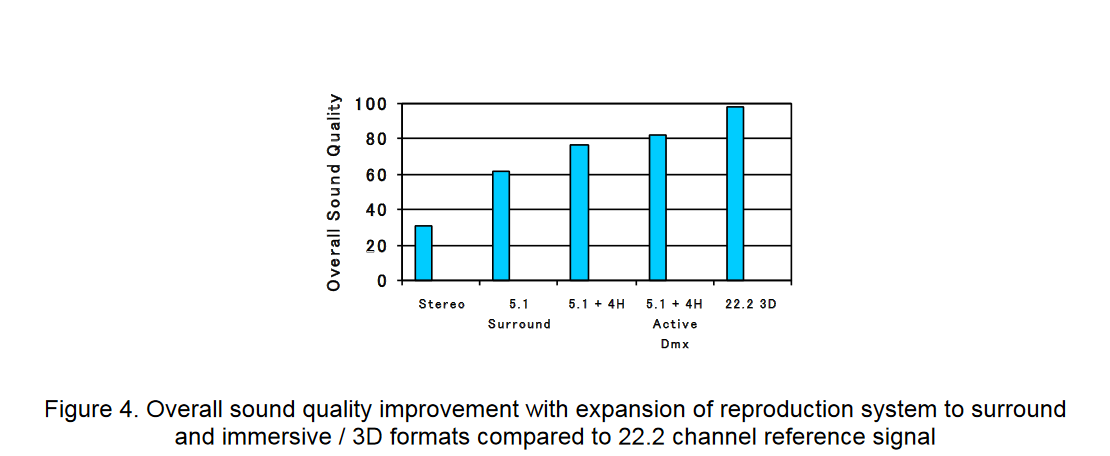

Thus, Silzle et al. undertook a study* to determine the relative overall perceived sound quality of several speaker configurations, to determine if a practical compromise was possible between the sound quality provided by a 22.2 system and today’s 5.1 and 2.0 formats. As shown in Figure 4, the perceived quality improvement from 5.1 surround to 22.2 is greater than that from stereo to 5.1. However, ignoring the LFE channels, an upgrade from stereo to 5.1 requires 3 new speakers, while an upgrade from 5.1 to 22.2 requires 17 new speakers.
* Silzle et al, “Investigation on the Quality of 3D Sound Reproduction”, International
Conference on Spatial Audio, 2011, Detmold, Germany

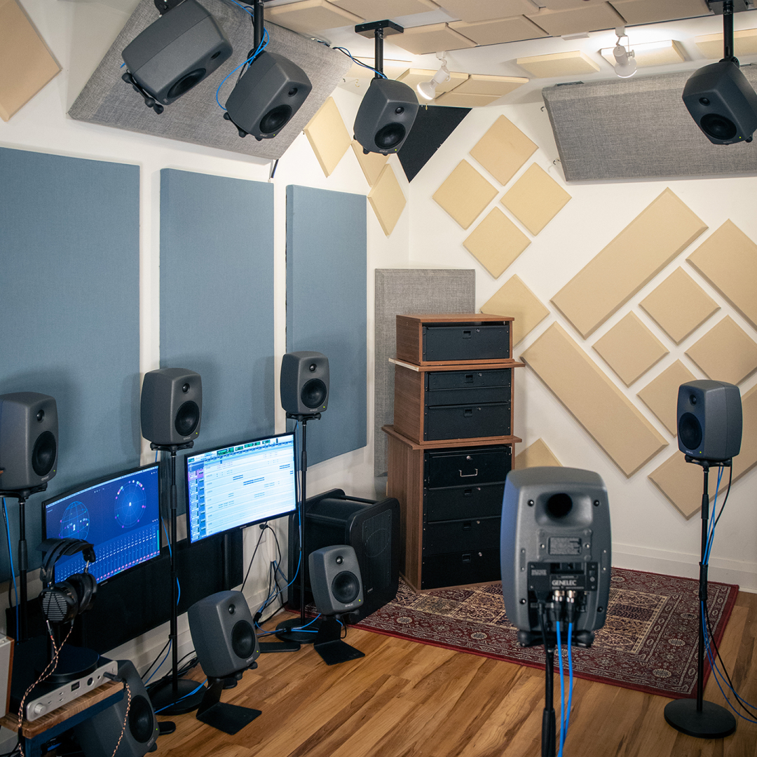

My Genelec monitor array is configured as a 13.1 Sony 360 Reality Audio setup. It consists of 13 8330 monitors and a 7360 subwoofer.
