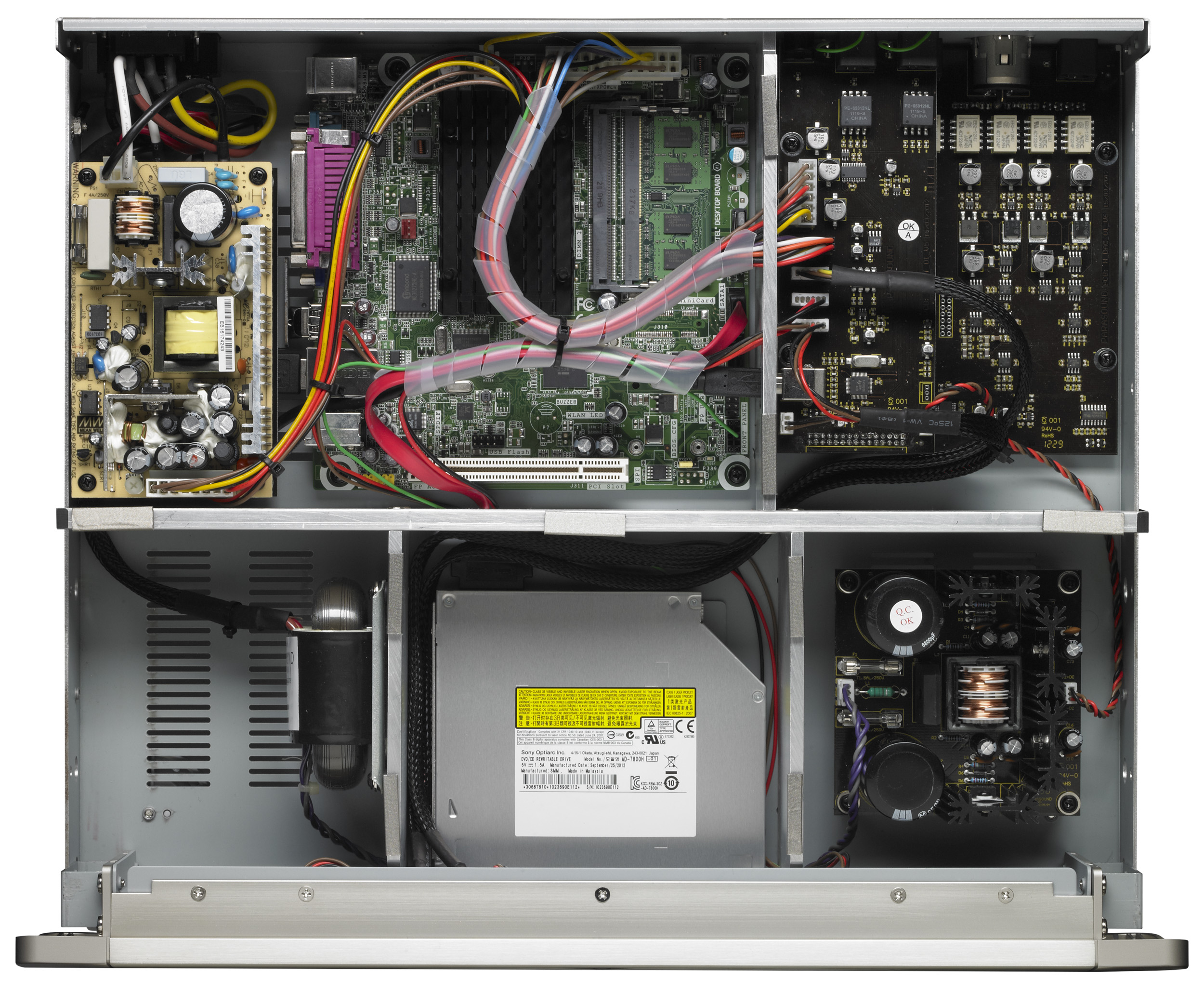

Motherboard? :rolleyes:
Motherboard ρε? >:(
Ναι ρε, να τρέχει κανέναν EAC light. :roflmao:
  • ROM drive spins four times faster than any CD drive
  • CD is read and analyzed multiple times until every bit is read faithfully
  • Audio bitstream comes from an immense memory buffer, not directly from the CD
http://www.parasound.com/cd1.php
http://www.exactaudiocopy.de/en/
