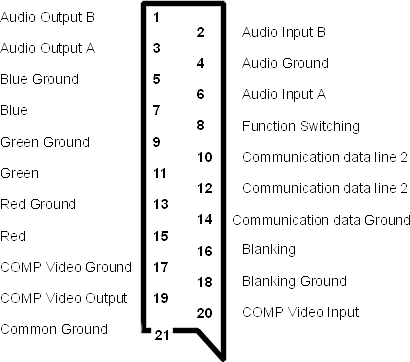

SCART Cables
The next step forward from coaxial cable was the introduction of the Euroconnector, more commonly referred to as SCART. It uses sockets to both the TV and the VCR, plus is the prime video connection used on satellite receivers, laserdisc players and DVD-Video. The SCART cable has up to 21 separate cables within the main cable and allows picture components and audio channels to be separated during transfer between the components. SCART cables are also bi-directional, allowing information to pass back from the TV to the VCR. Today, SCART connections are the most commonly used type of link between video recorders, video sources and televisions. In its basic form, a SCART cable carries one or two audio channels in each direction, plus a combined video signal (see Composite Video below), and most of the 21 cables are unused. For higher quality pictures, the video signal can be split into its component parts before being sent through the SCART cable. Further down this page you will find information about S-Video, RGB Video and Component Video connections. A SCART cable with all 21 wires fully connected can be utilised to carry each one of these superior types of transfer. This is done by allocating an individual wire within the SCART cable to a single component of the picture signal rather than combining them into a Composite signal. Because it is not necessary to combine the components from the source and separate them again at the television, the signal can be transferred with less information being lost.

Διαφώτισε με λοιπόν, για πες μου από ποια 5 pin του SCART, χωρίς τις γειώσεις, περνάει το RGB;

Μην την ψάχνεις, Γιώργο, απλώς έχει δημιουργηθεί μία σύγχυση με το πεντασύρματο RGBHV των υπολογιστών.
Η μεταφορά σήματος RGB μέσω Scart, χρησιμοποιεί το pin7 για το μπλε, το pin11 για το πράσινο και το pin15 για το κόκκινο, ενώ ο HV χρονισμός "τσιμπάται" από το pin20, το οποίο μεταφέρει το σήμα composite, κοινώς, μιλάμε για τετρασύρματη σύνδεση.

Συνήθως σε μια κατασκευή τύπου SCART - COMPONENT μεσολαβεί μέσα στην κατασκευή ένα κύκλωμα ώστε να ενισχύσει το σήμα του συγχρονισμού (πιν 17,20) που είναι σχετικά αδύναμο.
Επίσης θα πρέπει να ορίσει ώστε η συσκευή από την έξοδο scart να βγάζει σήμα RGB και όχι Composite.
