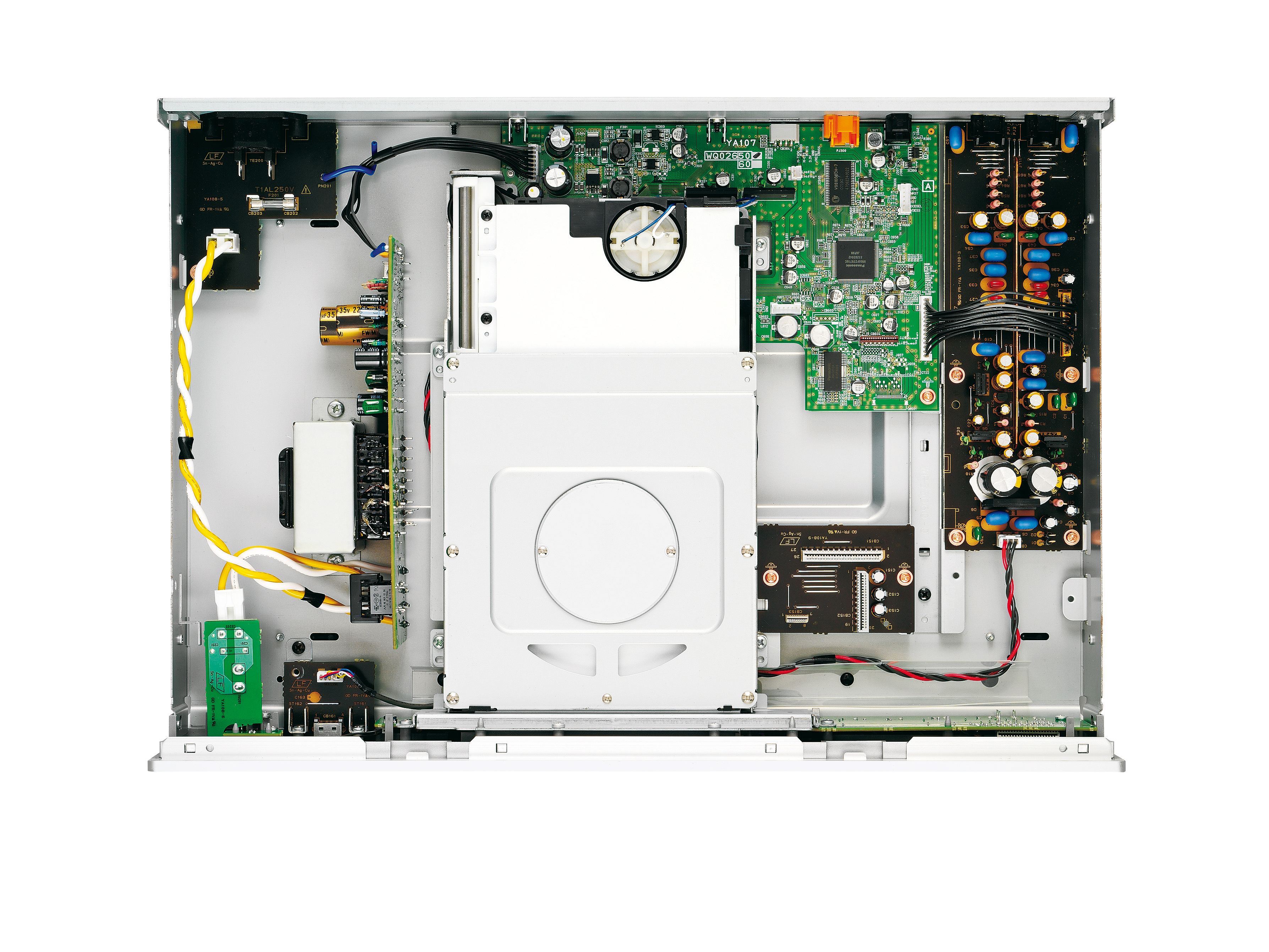

Yamaha CD-S700, με τον μηχανισμό της Yamaha από τα μεγαλύτερα players.
Yazaki:Yes. This mechanism was primarily intended to solidly support the CD drive with a stiff chassis, but by striving to lower the sound of the operation of the CD tray to the level of a luxury machine, we developed a new quiet loading mechanism using mesh wire. Through this design, we hoped to create a unit with a thin CD tray and no level differences. In the CD-S2000/S1000 we combined it with a thin aluminum diecast tray and in the CD-S700, we combined it with a thin BMC (high specific gravity resin) tray.
http://in.yamaha.com/en/products/audio-visual/hifi-components/amps/a-s2000__l/?mode=model#03 (Developer's Story)
