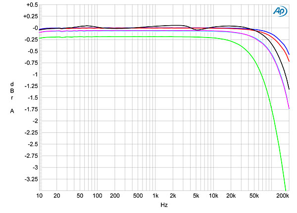

Fig.1 Soulution 710, frequency response at 2.83V into: simulated loudspeaker load (gray), 8 ohms (left channel blue, right red), 4 ohms (left cyan, right magenta), 2 ohms (green). (1dB/vertical div.)
http://www.stereophile.com/content/soulution-710-power-amplifier-measurements
The following sentence appeared in a review of the Soulution 710 published in October 2005 in the German magazine Stereo: "Lab chief technician Rolf Hahle has hung the test certificate for the Soulution 710 in a golden frame over his measuring desk." I wouldn't go quite that far, but the Soulution 710 is definitely one of the best-measuring amplifiers I have encountered. Color me impressed.
Fig.1 Wavac SH-833, 8 ohm tap, frequency response at 2.83V into (from top to bottom at 80Hz): simulated loudspeaker load, 16 ohms, 8 ohms, 4 ohms, 2 ohms (1dB/vertical div.).
Fig.2 Wavac SH-833, 4 ohm tap, frequency response at 2.83V into (from top to bottom at 80Hz): simulated loudspeaker load, 16 ohms, 8 ohms, 4 ohms, 2 ohms (1dB/vertical div.).
http://www.stereophile.com/content/wavac-sh-833-monoblock-power-amplifier-measurements
The SH-833's output impedance was on the high side, at 5 ohms from the 8 ohm transformer tap and 2.6 ohms from the 4 ohm tap. These figures were maintained across most of the audioband, with a rise at 20kHz from the 4 ohm tap to 3.6 ohms. Unexpectedly, the 20kHz source impedance from the 8 ohm tap dropped from 5 to 4.3 ohms. This difference in top-octave behavior can be seen in the amplifier's frequency-response plots from the 8 and 4 ohm taps (figs.1 and 2, respectively). The amplifier's output from the 8 ohm tap (fig.1) tips up slightly between 20kHz and 40kHz (more so into lower impedances), whereas that from the 4 ohm tap rolls off into lower impedances, reaching -3dB at 18.5kHz into 2 ohms (fig.2).
This rolloff will be audible, but is not that important. What is subjectively important is the SH-833's behavior in the bass. As with another amplifier using a circuit developed by the late Shishido-san—the Antique Sound Lab Explorer reviewed by Art Dudley in March 2004—there is a bass boost, the amount of which depends on the output transformer tap, the source impedance, and the load impedance. In the worst case, 4 ohm tap into 16 ohms, the boost reaches 9dB between 80Hz and 160Hz, while in the best case, 8 ohm tap into 2 ohms, there is a broad plateau 2dB high between 30Hz and 200Hz. With our simulated loudspeaker load, the high source impedance and exaggerated low frequencies produce a well-defined, 10dB peak at the woofer's resonant frequency.
So, that's that for the Wavac SH-833. I can't explain why Michael found its sound so seductive; all I can do is point to the measurable problems or audible idiosyncrasies that must be listened through to hear what it does right. All I have to do now is work out how to get this mondo amplifier back out of my basement and into the SUV so that Mikey can spend another couple of weeks luxuriating in its sound.

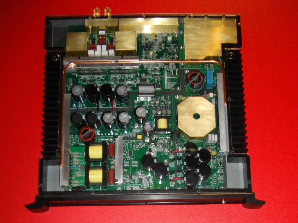

παρολο που εσωτερικα δεν μοιαζει καθολου τα specs του μοιαζουν με τον ucd2k αλλα με μεγαλυτερη
παραμορφωση.
προφανως αντιγραψαν το κολπο με το feedback μετα τα πηνια εξοδου για να μην πω στις μπορνες εξοδου.
