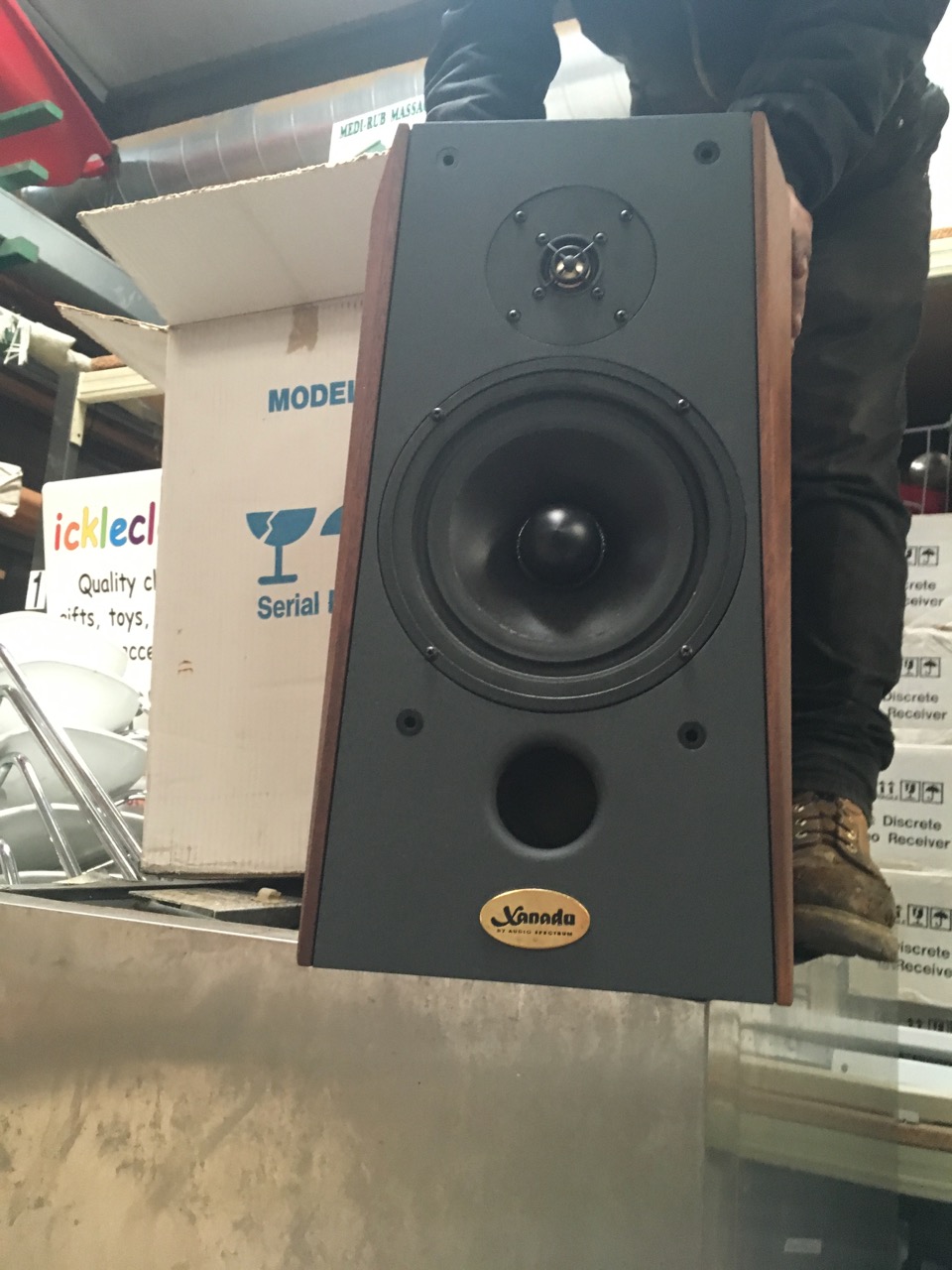

Hello!
I have found some new old stock AS speakers here in the UK. They are still in the original box and even sealed in their plastic. Strange enough, there are no labels and serial numbers. One set is the Xanadu, another is the Axxia (I think) and a big floorstander with no name. I have two questions:
1) can you post as much information as possible on these models? I cannot find anything online.
2) I have an old Arcam ∂ 290 (75W) which I can also bi-amp with another one. Which AS speaker do you think is best for me? I listen to records and to CD, mostly acoustic jazz, classical quartets and rarely some folk or progressive rock.
You are the only forum with lots of knowledge on the Audio Spectrum speakers, I really hope you can help me.
Thank you in advance! Massimo

You are a lucky man.
Xanadu better to be avoided, very demanding pair of speakers, if you feed it properly it can play hi-end.
If you can get Hermes TLS take it, they are fabulous speakers.
Go for it, worth every penny.
P.S. A good inspection of woofer suspension is absolutely needed. If they are made of rubber should be ok, if there is foam take a good look there was a problem with old SEAS drivers.

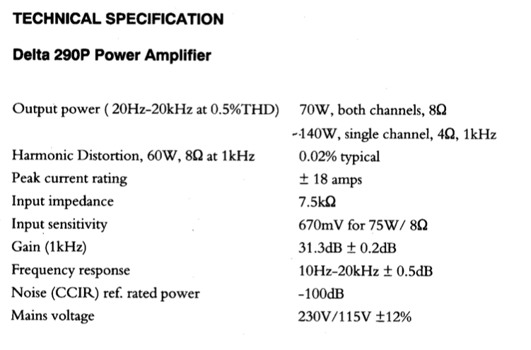

Thank you AGAIN! here is an update.
The Axxia are playing very well with my Arcam ∂ 290. In a way I could be happy with those, I probably can pay something like €50-80 for the pair, but after your comments I'm really tempted to get the Hermes!
I don't listen to music very loud. The Axxia sound more loud than enough with less than 1/2 volume up. For the Hermes, 91db sensitivity is pretty good, why you think that the 70W of the Arcam are not good enough? (see specifications in the picture) What kind of problems would I get?
Remember that I could bi-amp them. This should help, shouldn't it?
Do the Hermes require a large room? Mine is small.
Thank you for all your help!!!

Yeap...Hermes are too large for your room :(
IMO you should pick xanadu...
+ you will definitely need another amplifier...like ika said
