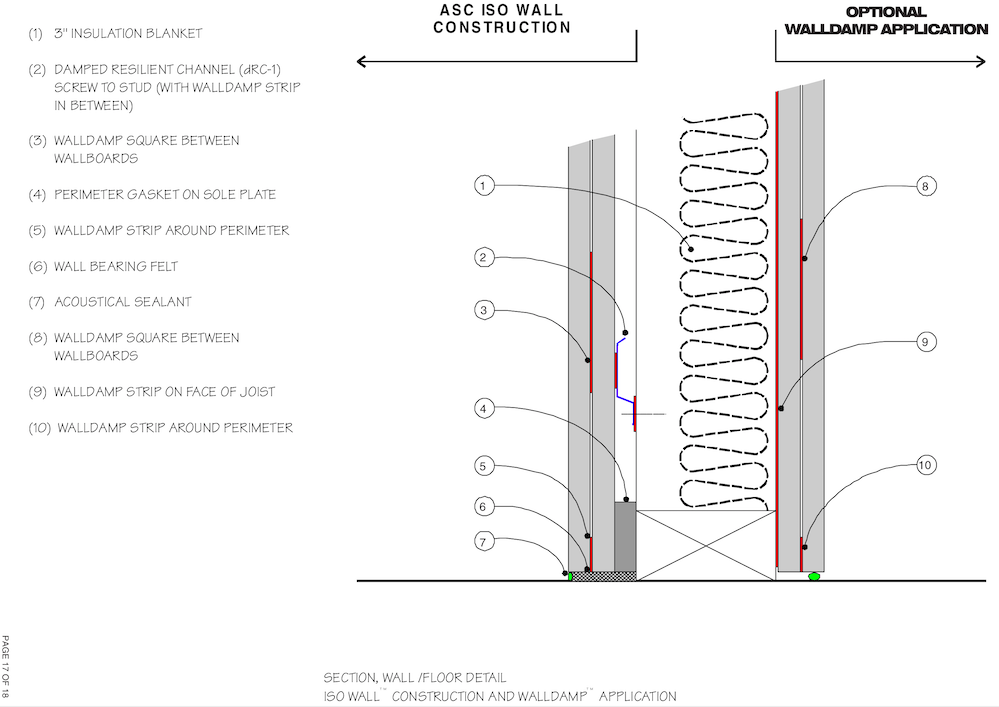

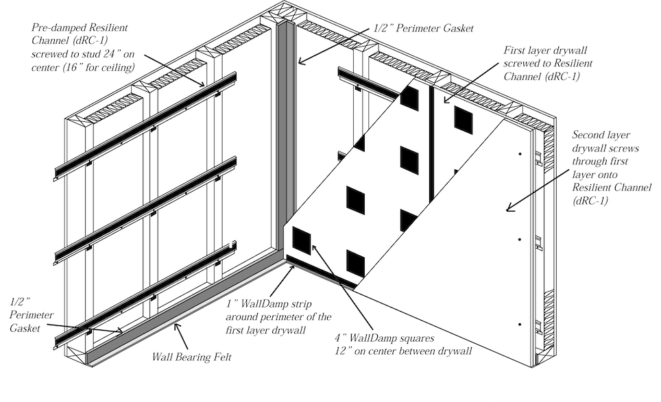

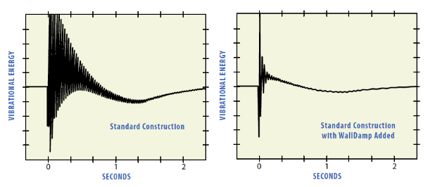

Back at the raw-framed listening room, I conducted an experiment to understand the effect of the stud dampers. I hit an undamped stud with a hammer and listened to the ring. Then I repeated the hammer strikes after installing the stud damper. The undamped stud rang for a long time; the damped stud produced a dull and short-lived thud. The difference was so dramatic that I recorded the experiment on my phone. Many weeks later, just before the drywall went up, I applied strips of ASC WallDamp viscoelastic material on the stud edges that face the house side of the wall for additional wall damping
