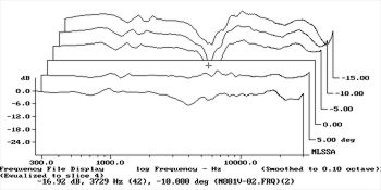

Και πάμε στο δια ταύτα: (μετρήσεις)
In its three iterations, the 801 was one of---if not actually the---best-selling high-end speakers of all time. Its use as a monitor was nearly universal in studios catering to classical recording, but its relatively low sensitivity (87dB) and somewhat ponderous bass response, especially when pushed, has limited the speaker's appeal in recent years, particularly in studios that specialize in synth-heavy pop and rock.
The bass driver itself is a shallow, 15" pulp-coned driver that operates as a piston because of its narrow operating band---it's used only up to about 400Hz.

The Nautilus 801's tweeter is 43" from the floor, which is a little high for a person of normal height sitting in a sofa. (A survey performed some years ago by Stereophile's Tom Norton revealed a remarkable uniformity of ear height. Short or tall people sitting on typical domestic sofas had an ear height of 33"-39".) Fig.7, which shows the changes in the B&W's response in the vertical plane, normalized to the tweeter-axis curve, reveals that as long as the listener sits with his or her ears between the tweeter axis and the midrange axis, the perceived balance will not change too much. But if you sit so you can see the top of the speaker, or---horrors---stand up, a deep suckout appears at the upper crossover frequency (indicated in this graph by the cursor).
The impulse response on the tweeter axis (not shown) is absolutely conventional, while the step response (fig.8) indicates that all three units appear to be connected with the same, positive acoustic polarity. As is usual with a high-order crossover design, however, the Nautilus 801 is not time-coherent, the tweeter's output arriving at the microphone a small fraction of a millisecond before that of the midrange unit, and the woofer's output lazily following that. :p:D:lol:

Turning to the time domain, the 802 D3's step response on the tweeter axis (fig.6) indicates that all four drive-units are connected with positive acoustic polarity, and that, in general, the decay of each unit's step blends smoothly with the start of that of the next unit lower in frequency. However, the output of the tweeter is very slightly too forward in time, which suggests that the B&W's optimal listening axis will be a little below the tweeter axis.
