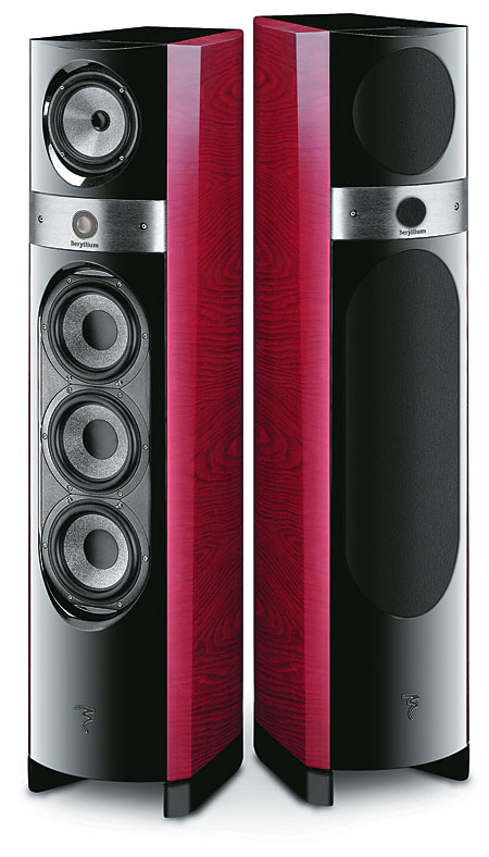

O Michael Fremer γράφει πολύ καλά λόγια στο review και ο Atkinson, απο το εργαστήρι του Stereophile, είπε "WoW!".
Προσωπικά δεν ξέρω πως παίζουν, αλλά τα άτιμα είναι κουκλιά...

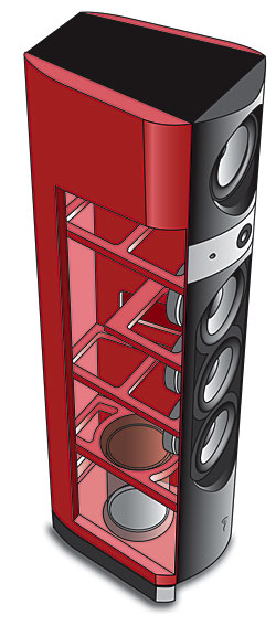

"Focal's new Electra 1037 Be ($10,995) is essentially a larger, more powerful 1027 Be, with the latter speaker's basic architecture and components. Both are three-way, bottom-ported designs, and both feature Focal's exclusive 1" inverted beryllium-dome tweeter with Infinite Acoustic Loading (IAL) enclosure and 6½" W midrange cone. In place of the 1027's two 6½" W cones, the 1037 features three 7" W drivers, which should result in improved bass extension, dynamic capabilities, and sensitivity.
The Electra 1037 Be's stack of three woofers necessitated a 6" height increase over the 1027, to 49", though the 1037 is only 1" wider and 2" deeper. Still, it weighs almost 40 lbs more: 112 lbs each. The result is a tall, graceful, imposing, wedge-shaped structure with stained redwood side cheeks, glossy, black curved baffle, recessed drivers, and flush-mounted grilles. It's probably the most attractive-looking speaker Focal has produced.

Ωραία κατασκευή και εξαιρετικά μεγάφωνα, αλλά από πού κι ως πού 8ωμο;

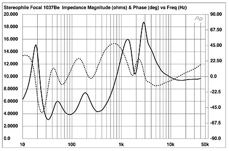

Ε, ξέρεις πως είναι αυτά τώρα... :mrgreen:
"The Focal Electra 1037 Be was significantly more sensitive than normal at an estimated 90dB(B)/2.83V/m. However, its plot of impedance magnitude and electrical phase (fig.1) indicates that it is a demanding load for the partnering amplifier in the lower midrange and bass. Not only is there a minimum value of 3 ohms at 33Hz, but there is a combination of 4.25 ohms and –47.5° capacitive phase angle at 27.3Hz. Fortunately, music with significant energy below 40Hz is relatively rare, but an amplifier that has no trouble driving 4 ohm loads at high levels will still be required. The fact that the impedance remains above 10 ohms for much of the treble means that the 1037 Be will tend to sound shelved-up in the highs with tube amplification."

υπεροχα
οδηγουνται και απο φορητο μπ3...
47 μοιρες απαπαπαπα...
Ας μου τα φέρει εμένα ο Άη Βασίλης και αναλαμβάνω εγώ να βρω ενισχυτή να τα οδηγήσει! :crazy_3:
Μεταξύ μας, έχουμε δει και πολύ χειρότερα... Εντάξει, δεν είναι το εύκολο φορτίο που φαίνεται στα specs του κατασκευαστή αλλά το πράγμα δεν είναι τίποτα καλύτερο και τίποτα χειρότερο απο αυτό που λέει ο Atkinson:
"...it is a demanding load for the partnering amplifier in the lower midrange and bass. Not only is there a minimum value of 3 ohms at 33Hz, but there is a combination of 4.25 ohms and –47.5° capacitive phase angle at 27.3Hz. Fortunately, music with significant energy below 40Hz is relatively rare, but an amplifier that has no trouble driving 4 ohm loads at high levels will still be required."
