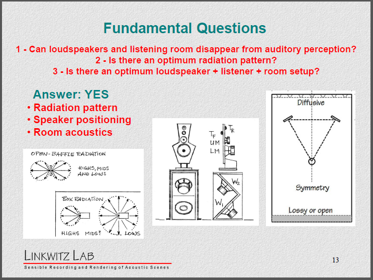

Φυσικά η δικιά μου η προσέγγιση είναι ερασιτεχνική και η γνώσεις ελλιπείς, κουβέντα θέλω να γίνει για να ΜΑΘΩ και εγω.
Ας δούμε λοιπόν τι λέει κάποιος που ισως.. ξέρει...
13) Fundamental Questions:
1 - Can loudspeakers and listening room disappear from auditory perception?
2 - Is there an optimum radiation pattern?
3 - Is there an optimum loudspeaker + listener + room setup?
My answer to all 3 questions is YES!
Provided that we have an appropriate
* Radiation pattern
* Speaker positioning and
* Room acoustics
1) Loudspeaker and room can disappear from perception, leaving only a phantom auditory scene in front of the listener, provided that the loudspeakers have essentially frequency independent directivity and provided that they are set up in the room with some distance from large reflecting surfaces, That way the reflected and reverberated sounds in the room have the same tonal character as the direct sound but are delayed such that the brain focuses on the direct sound and creates the illusion.
2) Here you see the sketch of an optimum directivity loudspeaker. It is a dipolar radiator from the lowest bass to the top of the frequency range.
Its radiation pattern is essentially a constant figure-of-eight at all frequencies. The typical box loudspeaker is omnidirectional at low frequencies and becomes more and more directional at high frequencies.
The optimum setup is symmetrical with respect to reflecting surfaces with the loudspeakers at some distance from them. The sweet spot is at the apex of the equilateral triangle, So nothing is new here, except that the sweet spot becomes very wide. The sound does not change when listening at greater distance or off-axis. Only the precision of imaging changes.
The listening room itself is optimized by being diffusive behind the loudspeakers and absorbing the sound behind the listener. Rather than a closed box the room should be thought of as a waveguide. The sound from the loudspeaker end of the room travels towards and past the listener and disappears without reflection. While this ideal may not always be achievable it can serve as a guide of where to provide diffusive and absorptive room surfaces.
With this type of room, this type of loudspeaker and listening room setup it is left up to the recorded material to establish the quality of the illusion.

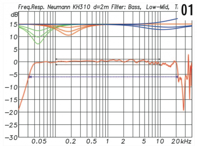

Και μια που το ανέφερε ο Μάνος, κοιτάχτε τι μέτρησε ο "άνθρωπος" στα 2 μέτρα...

Όσο διαβάζω τα pdf τόσο αρχίζω να πιστεύω ότι το "ηχειάκι" θα αποτελούσε ιδανικό "εργαλείο" σε οικιακό περιβάλλον....
Και μην νομίζεται ότι η Neumann "νοιάζεται" για εμάς...
Κυκλοφόρησαν κάποια στιγμή μετρήσεις κάποιας εταιρείας με την απόκριση συχνότητας ενός μονιτορ ηχείου της σε διαφορετικά studio... έγινε... το έλα να δεις... οπότε... ΞΕΡΟΥΝ.
Απευθύνονται σε τεράστιο κοινό και θέλουν να παίζει καλά σε πολλούς.
