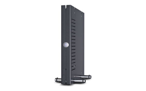

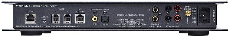

Διατίθεται εδώ και λίγο καιρό (και μέσω ebay-995£) το Linn Sneaky DS.
-Supported file types: WAV, FLAC, MP3 (native?)
-Audio sample rates: 7.35 k, 8 k, 11.025 k, 12 k, 14.7 k, 16 k, 22.05 k,
24 k, 29.4 k, 32 k, 44.1 k, 48 k, 88.2 k, 96 k, 176.4 k, 192 k
-Word depths: 16 – 24 bits
-Ethernet interface: 100Base-T RJ45
-Control protocol:Compatible with UPnP™ media servers, UPnP™ AV 1.0 control points
-Connector types : optical digital output, coaxial digital output, line outputs
-Inverted safety 4 mm BFA Sockets
-Output impedance: line outputs 300 Ω / speaker outputs 0.06 Ω
-Output voltage: line outputs 2.8 V peak, 2 V rms (0 dBFS) / speaker outputs 15 V peak, 10 V rms (0 dBFS, 16.6 dB gain,vol. 79)
-Output offset: line outputs < 2 mV / speaker outputs < 3 mV
-Signal-to-noise ratio: line outputs Better than -120 dB
-Channel balance: Better than +/- 0.2 dB
-Channel separation: line outputs Better than -120 dB / speaker outputs Better than -100 dB
-Gain range: -80 dB to +20 dB
-Gain resolution 1 dB
-Unity gain volume 0 dB = volume 80
-Dynamic range: 120 dB
-Damping factor: 67
-Signal level for clipping: 415 mV rms (0 dBFS, +16.6 dB gain, vol. 79)
-Harmonic distortion: < 0.03% at 1 kHz at 10 W
-Load tolerance: Unconditionally stable into all loudspeaker loads
-Frequency response: pre 2.5 Hz – 170 kHz (-3 dB) / power 2.5 Hz – 48 kHz (-3 dB)
-Speaker output voltage: 15 V peak
-Speaker output power: 20 W into 4 Ω
-Power consumption: Standby 10 W / Operational 14 W / maximum continuous 120 W
Mains supply voltage (auto-ranging) : 100 – 120 V ac (±10%) 50 – 60 Hz / 200 – 240 V ac (±10%) 50 – 60 Hz
-Fuse 250 V, T1.6 A (not user replaceable)
-Dimensions: 345 mm (w) x 44.5 mm (h) x 274 mm (d)
-Weight 2.7 kg
-Control Remote controllable (handset not supplied)
Τοποθείται και όρθιο (44,5 cm ύψος):
Δεν είναι κελεπούρι ακριβώς, αλλά ως linn θα μπορούσε να είναι και ακριβότερο.

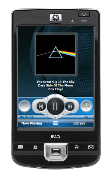

Συνεχίζοντας τα σχετικά-άσχετα με το sneaky, από το tracking σύστημα της linn:
Here are the projects we are playing with now...
Silverlight UPnP control-point implementation
UPnP control-point integration into Songbird, WinAmp, Window Media Player or your favorite desktop media manager
Browser integration with Subsonic or your favorite web-based music application
Innovative desktop integration
LinnGUI for Mac
FLAC support for Windows Media Connect
Innovative interaction models for playlist management and multi-room support
LinnGUI for Windows Mobile
LinnGUI for Maemo and the N800
UPnP AV alarm clock, House Audio Sequencer, and Auto DJ
IP Intercom
Voice controlled music selection
