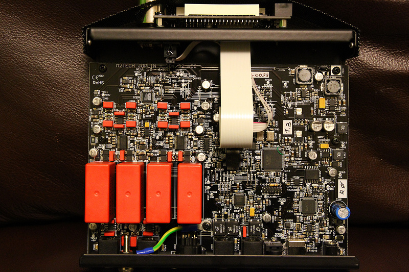

The Joplin is a very high performance analog-to-digital converter capable of 110dB SNR and up to 384/32 operation, with an USB port to connect it to a computer (as well as all other standard digital outputs capable of up to 192/24 operation).
To summarize the essence of the Joplin with the sentence above is fairly reductive. In fact, the Joplin is equipped with many interesting features which make it a complete solution to provide your system or your computer with the best analog front-end.
Noteworthy is the selectable analog input stage gain: 0dB (equivalent to 1.7Vrms for 0dBFS) to 65dB! This means that the full dynamic of the Joplin can be exploited even with sources providing a full-scale output as low as 0.95mVrms. This feature alone suggests to vinyl lovers that a cartridge can be directly connected to the Joplin inputs, to acquire the phono signal and equalize it in software on the computer.
But there’s more.
As owners of digital-only systems would love to connect a turntable to their digital amp, we provided the Joplin with comprehensive real-time equalization capabilities in digital domain: phono eq can be performed by the Joplin itself, thus outputting a digital signal ready for amplification out of a turntable, without the need for a phono preamp upstream the ADC inputs.
You may say: the Joplin is not the only ADC providing RIAA eq capability, and you’d be right. But the Joplin goes a long step further: use can choose from a complete set of eq curves, for microgroove LP’s, 78 rpm and even reel-to-reel tapes! All of this without the need for a computer, in real-time!
To complete the features set, the Joplin makes high-pass (anti-rumble) filters, low-pass (anti-hiss) filters and even an MPX filter (19kHz) available, to cope with noisy sources, warped records and FM signals coming out of tuners!

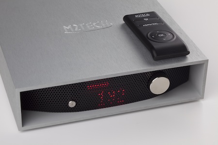

A high dynamic led VU-meter and an IR remote allow for full control of the Joplin.
Why choosing between analog and digital? Go for the Joplin and enjoy both!

DETAILS
High-speed asynchronous USB connection. Single-ended stereo input on RCA.
S/PDIF, AES/EBU and Toslink digital outputs. Auxiliary S/PDIF input for bridging.
Selectable input gain 0dB to 65dB. Wide choice of equalization curves in digital domain.
Various filter options (anti-rumble, anti-hiss, MPX). Remote control.
Encased in a stylish aluminium case.

Joplin is a high performance A/D converter capable of handing up to 384kHz sampling rates and 32 bits resolution (USB output).
It features a high speed asynchronous USB input based on the hiFace Two technology, further developped to allow for higher sampling rates.
A comprehensive output set (S/PDIF on RCA, AES/EBU on XLR and optical on Toslink) provide great connection versatility.
Also, an auxiliary S/PDIF digital input on RCA allows for re-using the digital connection used for the Joplin for a digital source,
as well as for redirecting the output from a digital source to a computer which is not provided with an S/PDIF input.
Despite its price, Joplin encopasses a leading edge technology for data handling and processing.
An FPGA is used to provide a seamless connection between the ADC IC and the USB port (both operating in master mode for low jitter reasons),
as well as for a large number of important clock and data routing tasks, not to mention the VU-meter drive.
The analog stage is based on the best PGA (Programmable Gain Amplifier) available on the market, and allows for gain as high as 65dB (equivalment to 0.95mVrms for 0dBFS).
A comprehensive set of equalization curves can be selected, to accommodate all phono formats ever used from 1925 to the present day,
plus eq curves for reel-to-reel tapes with straight output from the playback head.
The small size and stylish look of the Joplin allow for a uninvasive placement in every living space.
