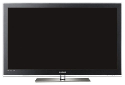

The Samsung PS50C6900 faces tough competition from Panasonic’s TX-P50G20, which has fallen to basically the same price over the months. In most areas, the Panasonic is a better Plasma TV, with much better out-of-the-box performance and deeper blacks – but it’s 2D only. Therefore, the people we recommend the PS50C6900 to are those who need a budget 3D display, and also those who are put off by Panasonic’s slightly noisier method of rendering motion. Those who care about aesthetics will also probably agree with us that Samsung’s flat-panel display is considerably more attractive than even Panasonic’s best styling efforts, which have a very practical, industrial feel to them.
We wish Samsung would stop treating its PDP line like an ugly stepchild, because we’d hazard a guess and say that more time spent rectifying the small issues present here would result in an even more recommendable product. For now, this flawed but capable Samsung PS50C6900 achieves “Recommended” status thanks to its excellent (calibrated) colour quality, its attempt at 3D, and its price. It has flaws, no question – but maybe the 2011 Samsung plasma lineup will be better yet. If we’re lucky, we’ll get to test one earlier than the end of 2011!
