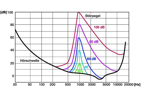

The number of bits is crucial for the dynamics
The maximum dynamics can be easily calculated roughly. Bit depth multiplied by 6 gives an approximate result of the theoretically usable dynamics. Calculated here for the most important bit depths: 16 bits = 96 dB, 24 bits = 144 dB and 32 bits = 192 dB. In comparison, our hearing has a maximum dynamic range of around 130 dB, which at first glance seems to be a considerable value. Without further knowledge, one would say that 24 bits are a must. But as is often the case, the situation is a bit more complex. But the hearing cannot easily handle the entire dynamic range, and neither can a hi-fi system.
Practical hearing
At the lower end of the dynamic range, the noise level plays a significant role. The average perception begins at 0 dB at 1 kHz (= reference sound pressure). But if you look at the noises in a "quiet" room with a sound level meter (e.g. on your cell phone), you will notice that there is a constant 10 to 30 dB of sound pressure. At the other end, most readers will probably agree with me that listening to music (at home) becomes unpleasant at more than 110 dB. This leaves about 90 dB of usable dynamic range. Since our hearing does not perceive the sound pressure as being equally loud across the entire hearing spectrum, to be precise, you would have to look at low, medium and high frequency ranges separately. For the sake of simplicity, we will ignore these for now.
More resolution?
Let's take a closer look at resolution. 24 bits means that theoretically 224 different values are possible, which is over 16 million. With 16 bits, that's 216, so only 65,500 values. So there we have it: much more resolution! That's true in theory, but in practice? More resolution means that smaller levels can be reproduced cleanly. For example, at -100 dB or even -120 dB, even the smallest signals can be displayed (relative to the digital reference point 0 dB).
But unfortunately that's no advantage if a) our entire playback system can only reproduce a maximum of 100 dB and b) these quiet signals are not perceptible at all because the background noise in our room covers up these minimal signal components. To create clarity, you can overlay the scales of the signal source (e.g. a streamer) and the entire music playback system. You can see this in the figure below. If the level ratios are correct, the maximum level should also be present in the digital range at the maximum sound pressure (in our case 110 dB), which is defined as 0 dB. This is because a digital level does not exceed this fixed point, but is "cut off" there due to the digital technology. In the analog range, signals can also be louder than the reference level. The signal is then also distorted, but usually cut off somewhat less abruptly, depending on the analog medium.
This means more or less that over 30 dB of the supposedly better resolution disappears in the background noise of the system or the ambient noise and thus remains inaudible(!). This is why there are excellent-sounding CDs that only have 16 bits available for dynamics (96 dB). In most cases, it will be difficult to even achieve 90 dB dynamics for the reasons mentioned above.
I will leave it up to you to judge how useful 32 bits are for an audio data carrier. 32 bits are useful for digital processing (DSP), but make little sense for data transmission or data carriers. Of course, there is also the question of how many dB the music can actually be "captured" with. Values >120 are probably utopian, with the exception of a bass drum perhaps. Microphone amplifiers and AD converters also have a background noise in practice, and even in recording studios the quiet sound level is likely to be in the range of up to 10 dB.
Masking effect
What exactly is the situation with our hearing? Our hearing has been studied for over a century, and even today scientists are still gaining new insights into it. What has been undisputed for decades, however, is the masking effect. This occurs when more than one tone is present. For example, if a 1000 Hz tone is present in the room, an acoustic mask forms around it in spectral terms. This means that our hearing can only perceive tones close to (especially above) this tone at a certain volume.
This significantly limits the perceptible dynamics, especially in music, because music consists of a large number of different, mostly harmonious tones. In addition to simultaneous masking, there is also temporal masking, which occurs after (and before!) loud tones. Anyone who has ever been to a really loud disco will certainly be familiar with the long-term effect of this effect. After leaving such an establishment, you will quickly notice that your hearing feels pretty numb for a while.
It is easy to see that it is difficult to make an exact statement about how much dynamics our hearing can process when a more complex frequency spectrum is present. The perceptible dynamics depend on pitch, sound pressure, number of tones present (including harmonics), etc. This background also explains why a record can still sound good despite various limitations, including in terms of dynamics (approx. 35 dB/50 Hz or 85 dB/1000 Hz).
The perception threshold (or hearing threshold) is also shown in the illustration above. This means that perception is only possible above this black line. This means that higher levels are needed for low and very high frequencies in order for us to perceive a sound. This means that the maximum possible dynamic range of our hearing is limited to a range of around 500 to 8000 Hz.
This in turn means that in this range, too, disturbances such as background noise should be as low as possible so that they are not audible. Anyone who owns a record player can easily understand the masking effect. At the beginning of the groove, where there is no music information, you can clearly hear the noise, which is no longer audible as soon as the music becomes a little more prominent. Loud crackles, on the other hand, (unfortunately) always remain audible.
