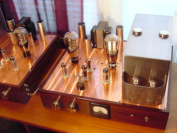

The Aurora: built by Gary Dahl, current sources by Gary Pimm, metalwork by Josh Stippich, rosewood chassis by Phil Bruckbauer, and circuit design by Lynn Olson.
