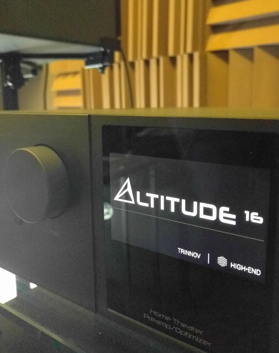

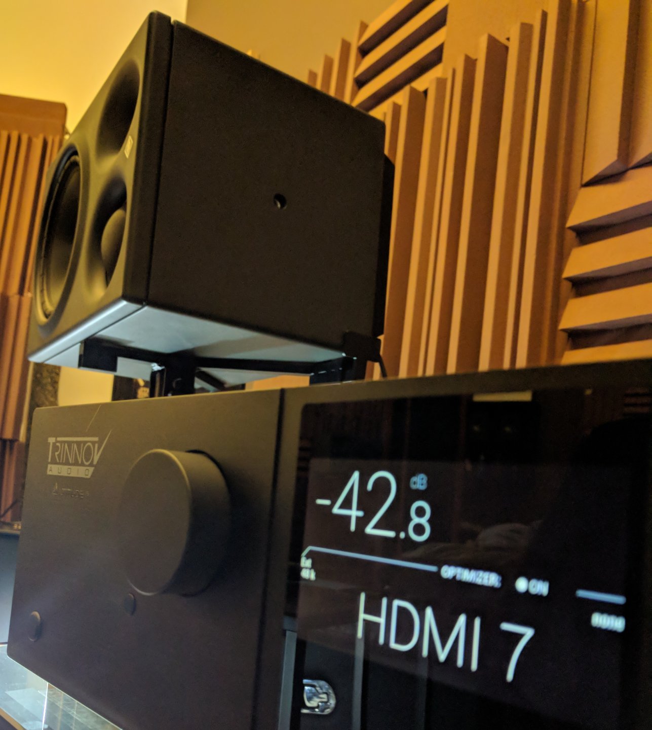

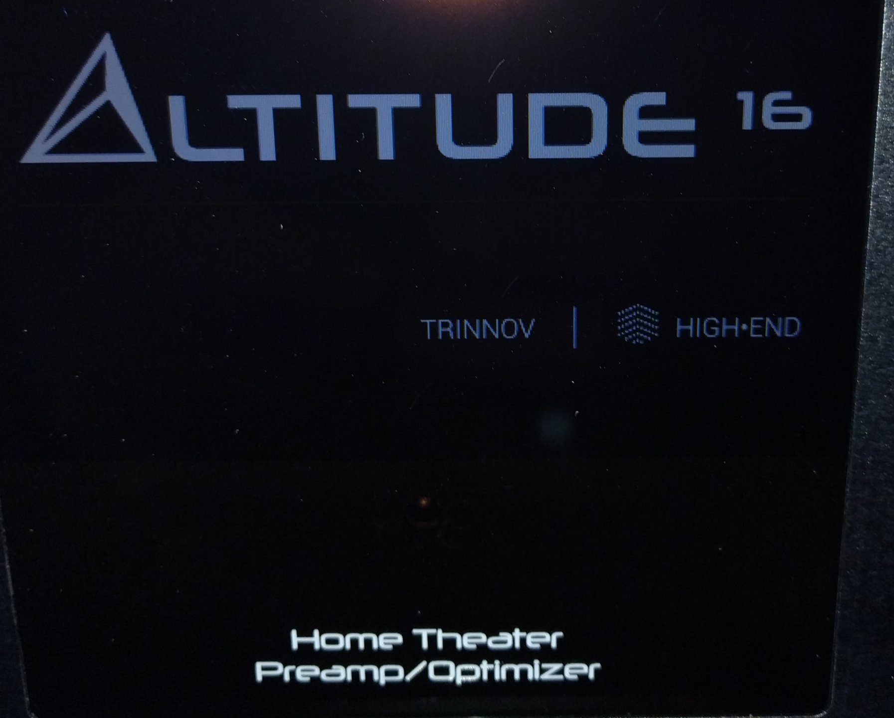

Αυτό, είναι high end κύριοι..8-)
Δια του λόγου το ασφαλές,ιδού και ο σκληρός πυρήνας του Hi-End (από το εγχειρίδιο χρήσης):
"...The Altitude16 provides very flexible options that help you to optimally configure the bass management of your system.
You can specify how the lower frequencies of each channel will be reproduced by one or more subwoofers.
Additionally, the revolutionary intermediary bass management will allow to bass manage the low frequencies of a small speaker (i.e. ceiling speaker) to the closest bigger speaker. This will help to relieve small speakers while keeping as much as possible the localization of the channel and so improve the immersion.
In other words, individual speakers can be bass-managed with any combination of subwoofers or bigger speaker with any specific crossover frequencies, filter type and slope..."
Καλορίζικο και με όλη την υποσχόμενη...εμβάπτιση.:D
