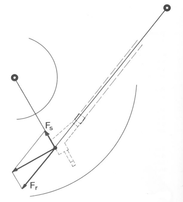

Skating is real. Not compensating for it makes no sense. The geometry of Increased tone arm length does result in a lower offset angle but that does not decrease skating by any appreciable amount and is therefore not among the advantages of a longer tone arm. Creating a tonearm with zero offset angle does not eliminate skating. Creating a tonearm with no overhang does eliminate skating at the point of tangency as demonstrated in the video, but only at that point and in fact, beyond that point the arm produces its own “anti-skating” as it wants to return to the point of tangency!

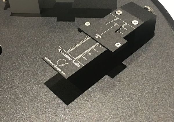

"the Acoustand Overhang Gauge is all the tool you should ever need to get the job done within minutes", that is only true if your pivot to spindle distance is 100% accurate, since the gauge depends upon that accuracy to accurately do its job.
