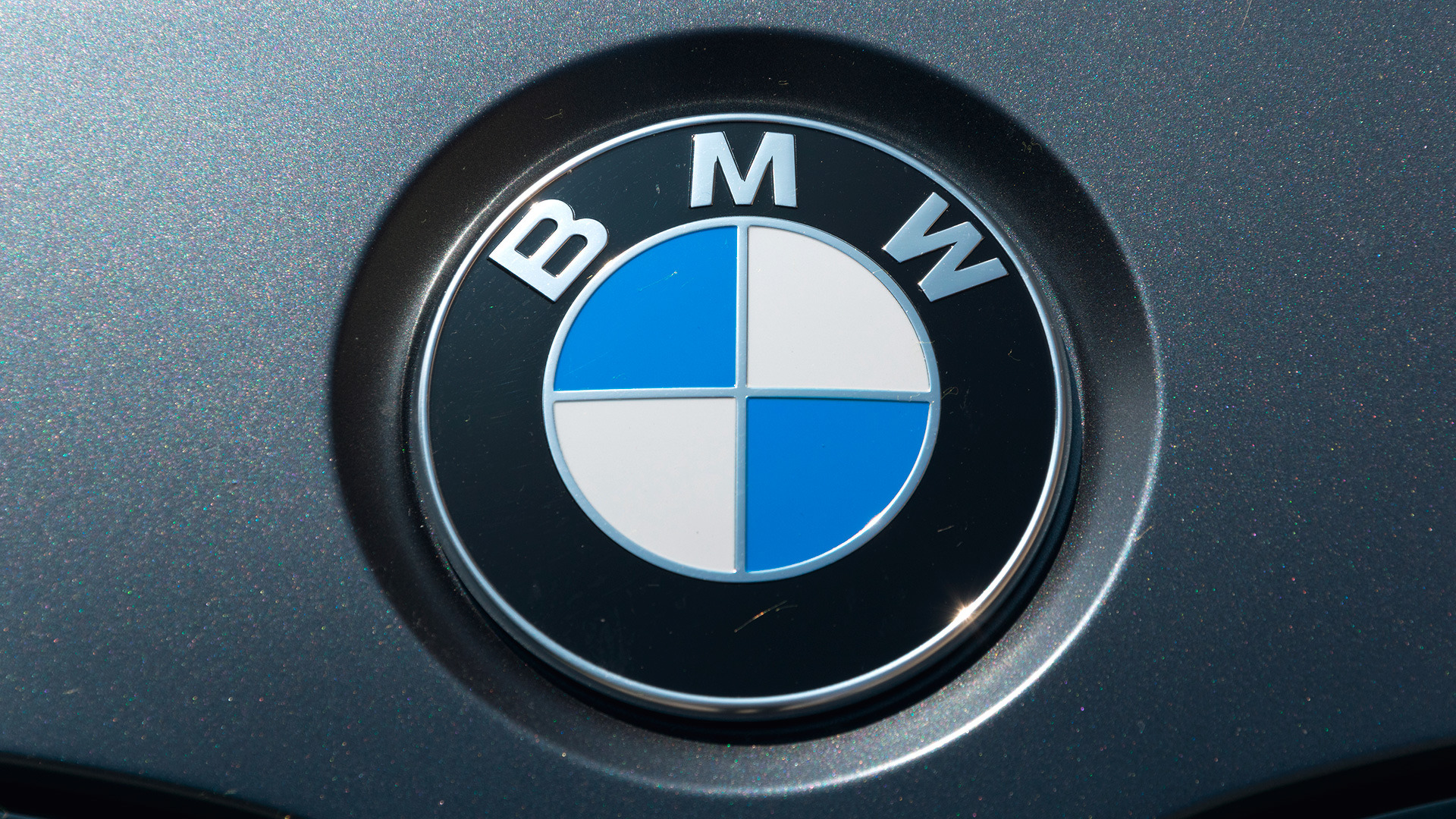

Νέες μπαταρίες και από την BMW, με υψηλότερη ενεργειακή πυκνότητα κατά 20%!
Compared to the battery cells widely used by the BMW Group in its fully-electric vehicles in the past, the battery's gravimetric energy density has been improved by about 20 percent at cell level in the BMW iX3.
