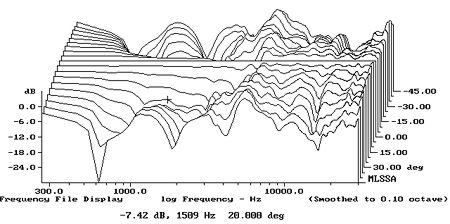

To ΄΄προπατορικό αμάρτημα΄΄ στις off-axis πάνω από τη ζώνη κρος που κάνει και αυτό το μοντέλο ΄΄βασανιάρικο΄΄ κατά την τοποθέτηση...
Fig.4 Wilson CUB, horizontal response family at 50", normalized to response on tweeter axis, from back to front: differences in response 90º–5º off-axis; reference response; differences in response 5º–90º off-axis.
Οι κατακόρυφες Allou Fun Park και λόγω της D'Appolito αρχιτεκτονικής...
Fig.3 Wilson CUB, vertical response family at 50", normalized to response on tweeter axis, from back to front: differences in response 45º–5º above-axis; reference response; differences in response 5º$45º below-axis

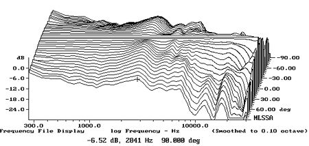

Τα γνωστά πλέον και ασυγχώρητα αμαρτήματα...
Fig.6 Usher Compass X-719, lateral response family at 50", normalized to response on tweeter axis, from back to front: differences in response 90 degrees-5 degrees off-axis, reference response, differences in response 5 degrees-90 degrees off-axis.
Fig.5 Usher Compass X-719, vertical response family at 50", normalized to response on tweeter axis, from back to front: differences in response 45 degrees-5 degrees above axis, reference response, differences in response 5 degrees-45 degrees below axis

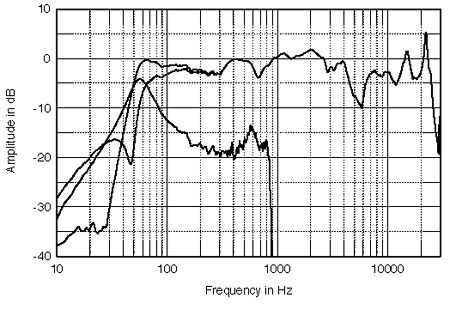

Στην ψευδοανηχοϊκή κυριαρχεί η άποψη του σχεδιαστή, το λεγόμενο...΄director's cut΄΄. :sneaky:
Fig.4 Red Rose R3, anechoic response on tweeter axis at 50", averaged across 30 degrees horizontal window and corrected for microphone response, with the complex sum of the nearfield woofer and port responses plotted below 300Hz.

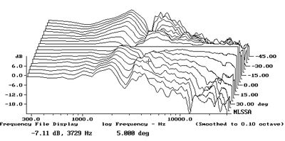

Fig.5 Red Rose R3, lateral response family at 50", from back to front: responses 90 degrees-5 degrees off-axis, reference response on tweeter axis, responses 5 degrees-90 degrees off-axis.
Fig.6 Red Rose R3, lateral response family at 50", normalized to response on tweeter axis, from back to front: differences in response 90 degrees-5 degrees off-axis, reference response, differences in response 5 degrees-90 degrees off-axis.
Fig.7 Red Rose R3, vertical response family at 50", from back to front: differences in response 45 degrees-5 degrees above tweeter axis, reference response, differences in response 5 degrees-45 degrees below tweeter axis.

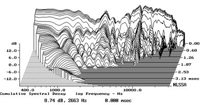

Fig.10 Red Rose R3, cumulative spectral-decay plot at 50" (0.15ms risetime).
Ο ΄΄πολύς΄΄Mark Levinson ως κατασκευαστής των ηχείων είχε ξεσπαθώσει ενάντια στις δημοσιευμένες μετρήσεις υποστηρίζοντας ότι η ομάδα του τα έφτιαχνε όλα με το αυτί και υπονοώντας μεταξύ άλλων ότι δεν γίνεται να λογαριάζουμε τις επιδόσεις ηχείων υπό ορθολογικούς όρους αφού τέτοιοι όροι δεν επικρατούσαν στη Μουσική...

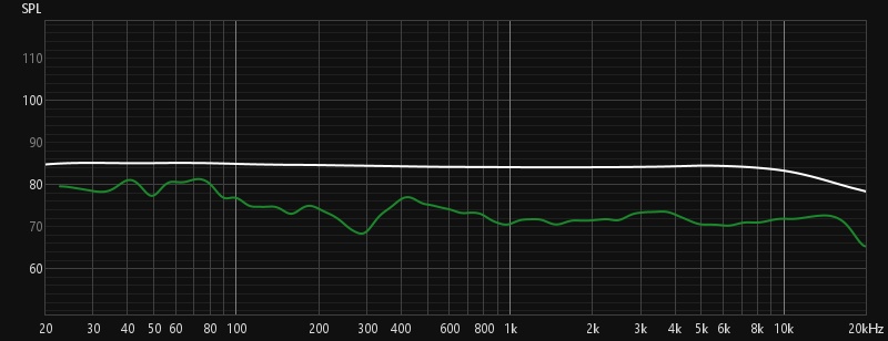

Τώρα άμα σου πω ότι αυτό που παρατηρώ είναι μια απόκριση συχνότητας διχοτομημένη με το τμήμα έως τα 300 Hz να μη βρίσκεται σε συνοχή αφού εκτείνεται σε... διάφορη στάθμη αναφοράς προς το τμήμα πάνω από τα 400 Hz ελπίζω να μη σε aπογοητεύω... Δεν είναι καλή επίδοση αυτή.

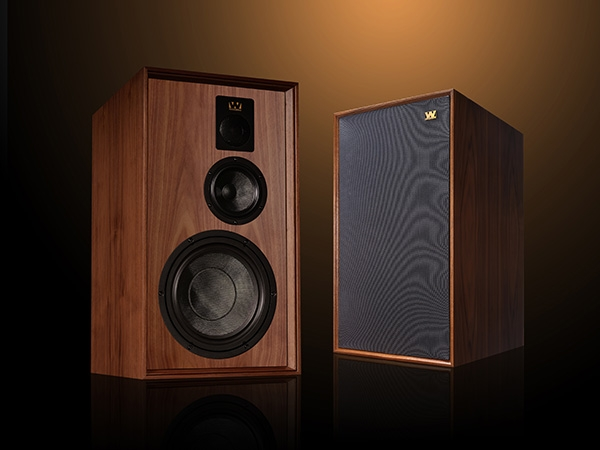

Πάμε λοιπόν με δύο ηχεία ΄΄Back to the Future΄΄ αφού συνδυάζουν υποτίθεται ρετρό εμφάνιση με σύγχρονους όρους υλοποίησης...
Wharfedale Heritage Series 90th Anniversary Dovedale
Τίτλος δομημένος όπως τα ονόματα παλαιών ισπανών αριστοκρατών...

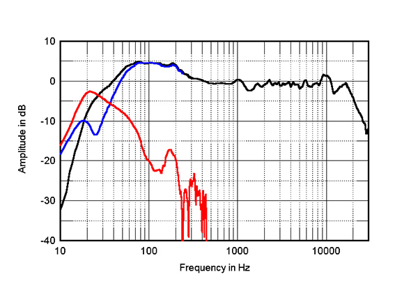

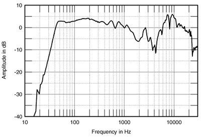

Σύγχρονη και αποδεκτή η on-axis:
Fig.3 Wharfedale Dovedale, anechoic response with grille on tweeter axis at 50", averaged across 30° horizontal window and corrected for microphone response, with the nearfield responses of the woofer (blue), ports (red), and their complex sum (black), respectively plotted below 300Hz, 500Hz, and 300Hz.

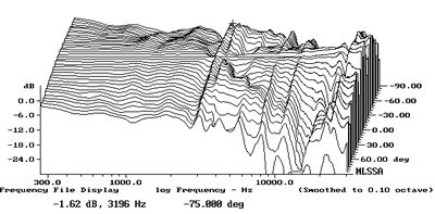

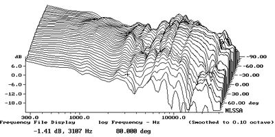

Οι off-axis όμως μας σπρώχνουν πίσω στις εποχές των απαιτητικών τοποθετήσεων και ματσαρισμάτων με άλλα συνοδά...
Fig.4 Wharfedale Dovedale, lateral response family at 50" with grille, normalized to response on tweeter axis, from back to front: differences in response 90–5° off axis on side opposite drive units, reference response, differences in response 5–90° off axis on drive unit side.
Fig.5 Wharfedale Dovedale, vertical response family at 50" with grille, normalized to response on tweeter axis, from back to front: differences in response 20–5° above axis, reference response, differences in response 5–15° below axis.

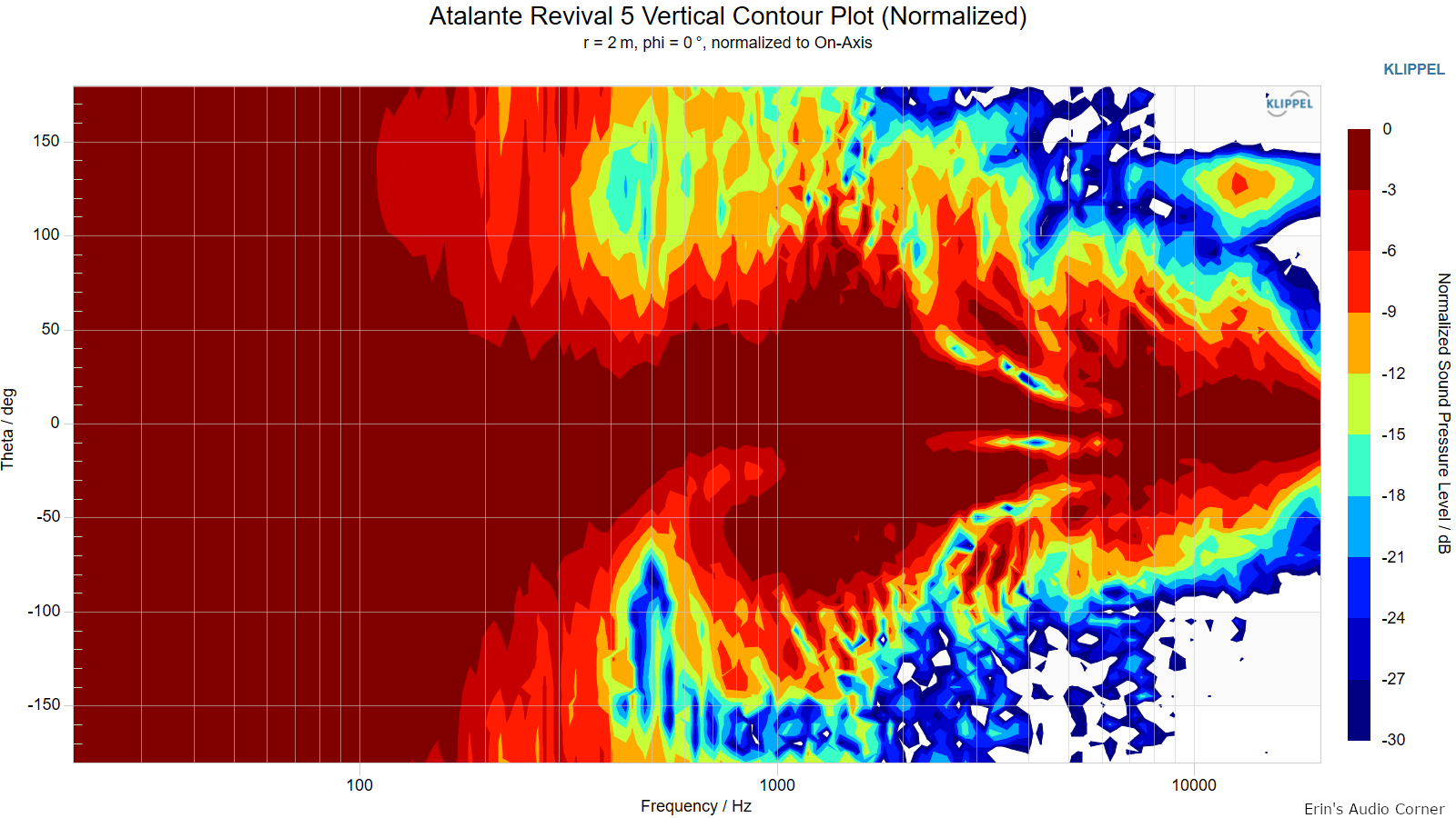

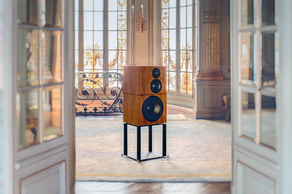

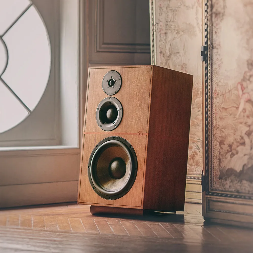

Revival Atalante 5
Στο δεύτερο οι εναλλακτικές προτάσεις στησίματος, η κατακόρυφη διασπορά και η άνοδος των παραμορφώσεων μαζί με τη στάθμη και παρά το δωδεκάρι woofer με το θόλο για τις μεσαίες το καθιστούν... ατάλαντο όνομα και πράμα. :sneaky:

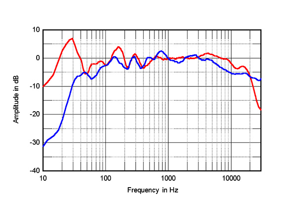

Fig.6 Wharfedale Dovedale, spatially averaged, 1/6-octave response in JA's listening room (red) and of the KEF LS50 (blue)

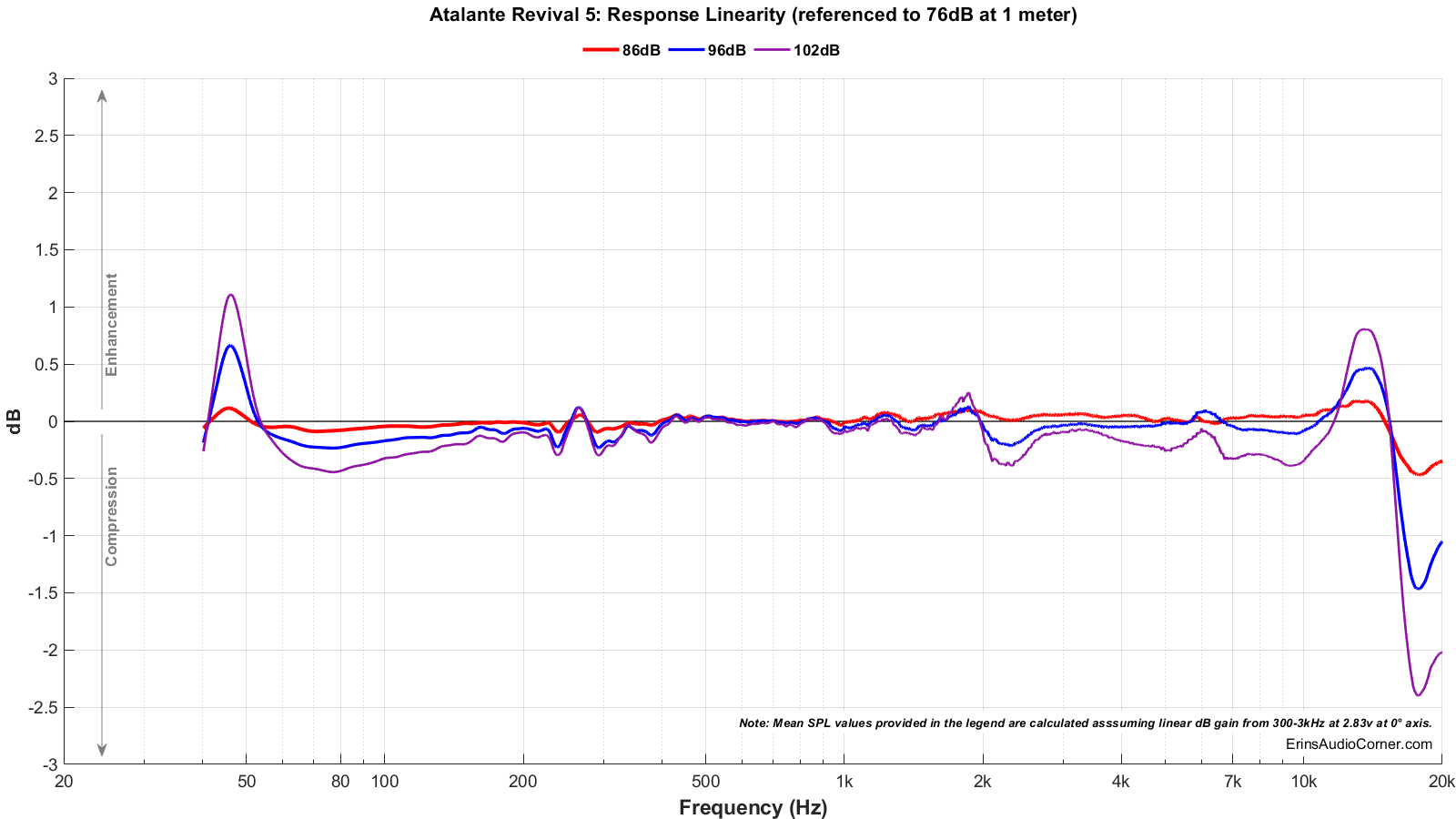

Revival Atalante 5

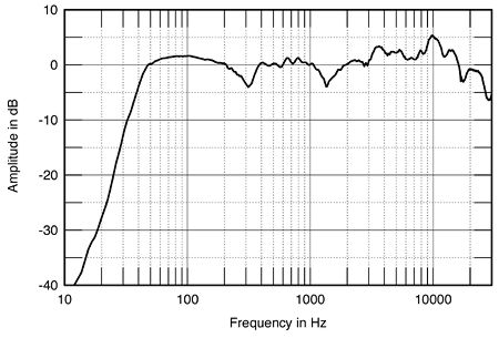

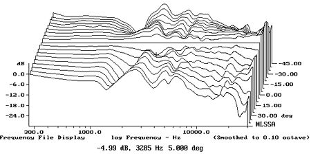

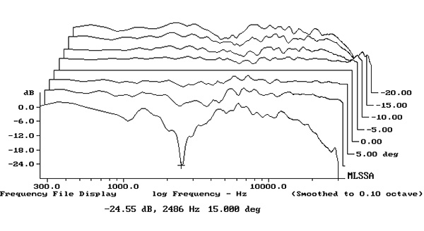

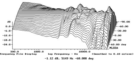

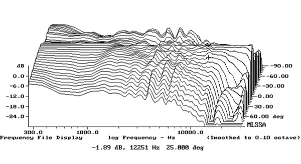

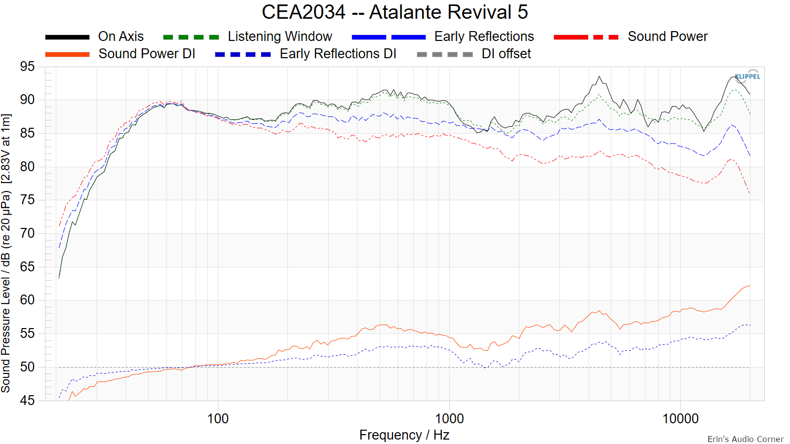

Revival Atalante 5
Το ανησυχητικό είναι ότι το Atalante 5 ήταν, προ δύο ετών, εκείνο το ηχείο που στην έκθεση hifi (κάπου στην Κηφησίας) άρεσε σε πάρα πολύ κόσμο -και σε εμένα ομολογώ- τουλάχιστον στα ήπια ακούσματα που έπαιζαν στο δωμάτιο (γιατί σε κάποια ροκ παρενθέσεις δεν...). Είμαστε άραγε τόσο αδαείς ή τόσο "κατευθυνόμενοι" από την εικόνα αντί του ήχου;

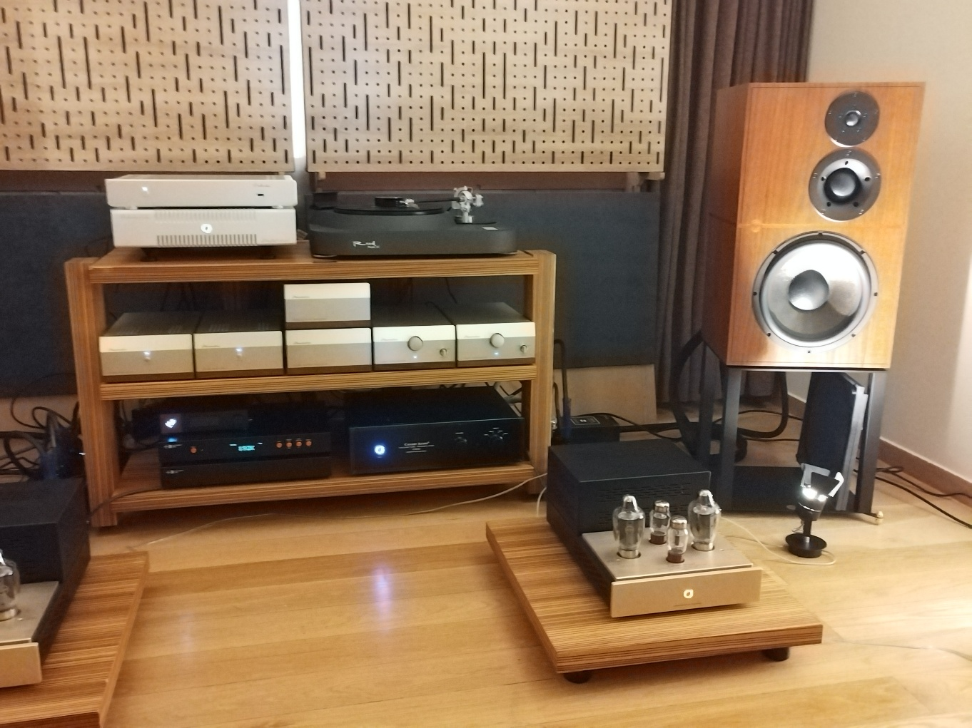

Τώρα που είδα το post του bhutia με το Linn Akurate, θυμήθηκα ένα πολύ συμπαθητικό παιδί που είχε έρθει από τη Σκωτία στη Θεσσαλονίκη για να προωθήσει και να εξηγήσει τέλος πάντων, και ούτε λίγο ούτε πολύ, νόμιζε ότι όταν ελλατώνονται οι στροφές στο cd player, αλλάζει και το pitch, και το πίστευε κιόλας! Το δε Akurate, σε απόσταση 5 μέτρων πάσχιζε να παίξει μπάσο. Τί μπάσο να παίξουν δυό 6,5σάρια, το καημένο το μηχανάκι...
Κωστα περα απ το μπασο τι εντυπωση σου εδωσε το ολο συστημα?
5.169
4.516
Τα ηχεια συνοδευοταν απο πολλους ενισχυτες ξεχωριστα για την καθε μοναδα του ηχειου. Η αξια των ενισχυτων περιπου 40.000 Αν δεν μ απατα η μνημη μου, αυτα που εβαζε να παιξουν ηταν κομματια που δεν ειχαν ιδιαιτερες χαμηλες συχνοτητες. Κυριως φωνες, κιθαρα και τα γνωστα που βαζουν σε χαιντεδακες εκδηλωσεις.
