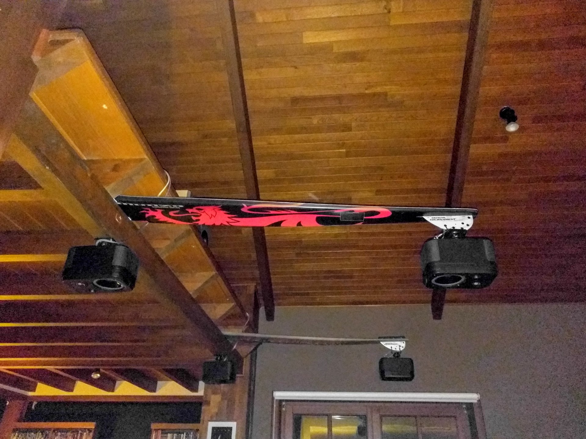

Conclusions
We can draw the following conclusions:
  1. ANY room, even those with quite high ceilings, that uses ceiling Atmos speakers firing straight down requires that those speakers have very wide coverage.
  2. Angling speakers significantly reduces the coverage requirements.
  3. As the room gets lower the coverage requirements increase.
All this goes to show that a very critical part of any home theater design is ensuring the speakers selected can provide consistent coverage of the seating area. You really can’t select a set of speakers unless you know what the coverage requirements are, and you also have to know what the speakers are capable of as many manufacturers provide no data or specifications.
The rabbit hole
Of course we have tried to keep things simple in this article but there is more complexity to consider with a Dolby Atmos speaker layout:
  • Coverage across the width of the room.
  • Differences in SPL due to some seats being closer / further away than others. This needs to be considered when the speakers are positioned.
  • Off axis suckouts. Most speakers (with exception of some coaxials) have a suckout somewhere off axis due to path length differences between the tweeter and midrange drivers. If you know where these suckouts are you can position the speakers accordingly.
  • Timbral matching. All the surrounds speakers should sound identical, and should also sound the same as the LCRs. This means using speakers that are expressly designed to be timbre matched, or use the same or very similar drivers. We’re seeing many enthusiasts use ceiling speakers from a different manufacturer to their LCRs and surrounds.
http://www.acousticfrontiers.com/dolby-atmos-dispersion-requirements-for-ceiling-speakers/
.... οποτε θελετε ομοαξονικα ηχεια για καθετη ριψη ....η κλιση στα ηχεια σας αναλογα το ηχειο ....η αλλες μοιρες τοποθετηση (οχι 45) αναλογα το ηχειο για καθετη ριψη !!!
γιαυτο μια τα εχετε καθετα και μια με κλιση....δεν εχετε κανει σωστο υπολογισμο και τα βαζετε τελικα οπως σας αρεσουν :D
απλα πραματα...:)

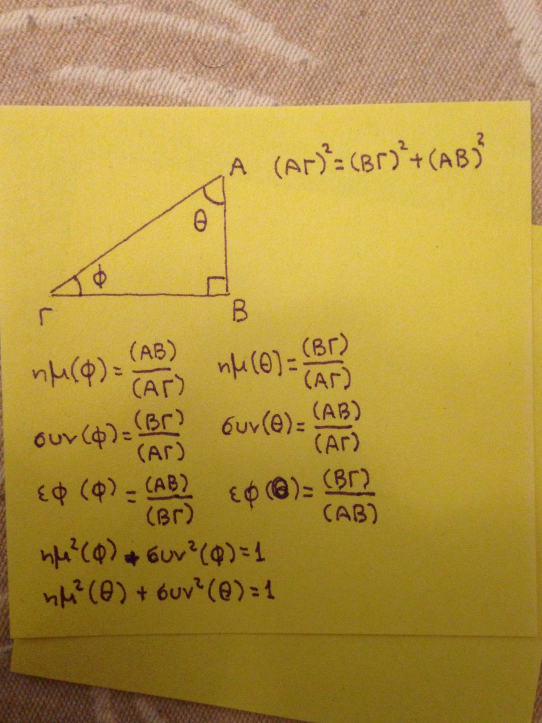

σήμερα που τσέκαρα τα τρακιν νάμπερ έδειξαν ότι έφτασαν τα μαραντζάκια τουντέι Ελλάδα
οπότε είπα να μετρήσω που θα τρυπήσω για να βάλω τα ταβανοηχεία σύμφωνα με τις προδιαγραφές στα μάνουαλ
για 7.1.2
σίγουρα δεν έβαλα τον παράγοντα διασπορά...γιατί κάθε ηχείο είναι διαφορετικό
οπότε ότι δείτε συνυπολογίστε και αυτό τον παράγοντα του ηχείου
απόσταση ταβανιού 2.80
με (ΒΓ) = 1.60 απόσταση κεφαλιού από ταβάνι(έβαλα το Γωγουλίνι μοντέλο στον καναπέ και μετρούσα με μεζούρα την απόσταση:roflmao:) αφαιρούμε και το βάθος του ηχείου (15cm) οπότε μας μένει 1.45
επιδιωκόμενη γωνία φ 10 μοιρών από τη θέση ακρόασης (κεφάλι)
η απόσταση ΑΒ είναι περίπου 25.5 εκατοστά πιο μπροστά από το κεφάλι του ακροατή
(Κωστή μην πεις κουβέντα για την ντόλμπι...απλά πράματα λέμε!:roflmao::roflmao::lolsign:)

Οχι ρε φιλε τριγωνομετρια... ελεος με το πυθαγορειο θεωρημα με γυρισες πολλα χρονια πισω...
Εγώ να δεις όταν έψαχνα να βρω τους τύπους
θυμήθηκα το λυκειάρχη μου που μας έλεγε...έχουμε ένα τρίγωνο αβγδ:headbang::headbang::roflmao::roflmao:
