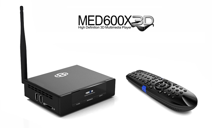

New MED600X3D will soon be available in Europe
MSRP
MED600X3D (No WiFi) €139.95
MED600X3D-WP (Inc PCI WiFi) €159.95
Processor: RDT1186 - 750Mhz - 512MB SLC Flash - 512MB DDR3 SDRAM
Video Fomats Supported: AVI/BDMV Light/BDISO Light/MKV/TS/TP/TRP/M2TS/MPG/MP4/MOV/DiVX/M4V/VOB/ISO/DAT/WMV/ASF/RM/RMVB/FLV resolution up to 720p/1080i/1080p
3D Video: Full 3D/Side By Side/Top & Bottom/Frame Sequential/Frame Packing.
Audio Codec Supported: MP3/MP2/OGG Vorbis/PCM/LPCM/AAC/RA/Dolby True HD - DTS MA Passthrough on HDMI/AC3 - DTS 5.1/Flac up to 24bit 192Khz/WAV/WMA Standard (DRM & Advanced Profile not Supported)
Photo format Supported: JPEG/BMP/GIF/TIFF/PNG
File System Supported: FAT32/NTFS/HFS+ (MAC)
Video Output Resolution: NTSC/PAl/480P/576P/720P/1080i/1080p/1080p 24Hz input
Output: HDMI 1.4/Component Video/Composite Video/ Stereo RCA/SD/SDHC/Sony Pro Duo Card Slot/SPDIF Optical/Host USB USB 2.0 x2
Optional WiFi: MED10WFB or MED20PCIE (Wifi is optional unless otherwise stated on the packaging)
Contents: MED600X3D(Or MED600X3D-WP)/RC/2x AA Batteries/AC Adapter/HDMI 1.4 Cable/AV Cable/Manual.
