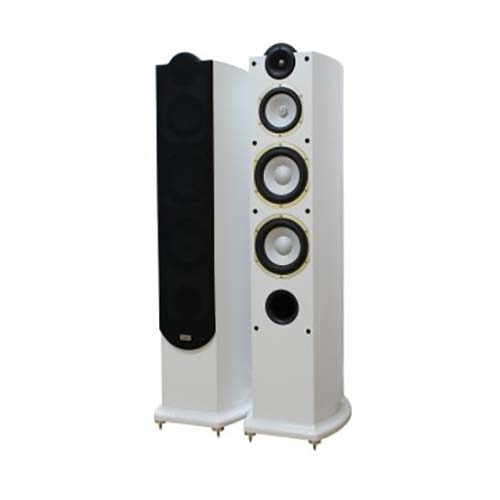

Aυτα τα ηχειακια πως τα βλεπεις? απο τον αντιπροσωπο.www.atrade.gr
Platinum F-100v.2 TagaHarmony Ηχεία Δαπέδου HGWhite (ΖΕΥΓΟΣ)
SKU: F100v.2-HGW
Platinum F-100v.2 Floorstanding Speaker-High Gloss White-ΖΕΥΓΟΣ
Taga Harmony
839,00 €
Design:
3-way, 4 drivers, floorstanding, Bi-wiring
TLIE Enclosure,
crossover points 700Hz 4kHz
High-Frequency Driver: 25mm (1”), TPTTD, TWG faceplate, TTP
Midrange Driver: 133mm (5.25”), TPACD
Bass Driver: 2 x 165mm (6.5”), TPACD
Recommended Amplifier Power: 20-250W
Frequency Response: 30Hz-40kHz
Impedance: 6 ohm
Sensitivity: 92dB
Dimensions (H x W x D): 108,9 x 25 x 34 cm
Weight (net): 40.2 kg pair
