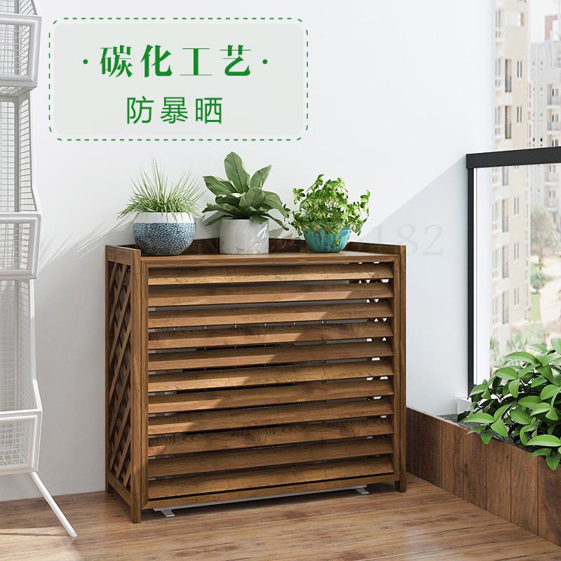

Τώρα φτιάχνω κάτι τέτοια για τα AC.
Air-conditioner-outer-unit-rack-flower-shelf-balcony-outdoor-host-shielding-air-conditioner-ou...jpg
