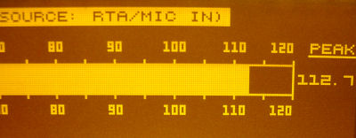

Για να δεις την καμπύλη απόκρισης, βάζεις ροζ θόρυβο (20Hz-20KHz). Η στάθμη οφείλει να είναι λίγο υψηλή, ώστε να μην επηρεάζεται από ήχους περιβάλλοντος και να περιλαμβάνει όλες τις ανωμαλίες του δωματίου.
Τις μετρήσεις μου τις κάνω σε υψηλές στάθμες, συνήθως λίγο πάνω από τα 110db.

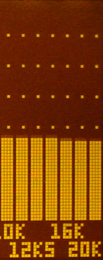

Αυτό είναι το συμπέρασμά μου, διότι με (επιτυχές) τέτοιο "target responce curve", κατά την άνοδο του real time analyzer οι μπάρες συχνοτήτων βρίσκονται όλες στην ευθεία, ενώ όταν σταθεροποιούνται δείχνουν τα εξής:

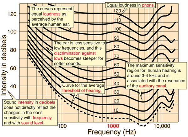

Intensity vs. Loudness
Sound intensity is a measurable quantity relating to acoustic energy whereas loudness is a subjective quality affected by the human auditory response to sound.
The Sonic Research Studio at Simon Fraser University defines sound intensity as “The sound energy transmitted per unit time through a unit area, thereby being a measure of the magnitude of a sound.” This ‘magnitude of sound’ is measured in Sound Pressure Levels (SPL) and is defined as:
Where Pref = 20 ΅Pa = 10-12 W/m2. It is also known that the intensity of sound decreases according to the inverse square law, where r is the radius from the sound source.
So, how does sound intensity relate to perceived loudness? As mentioned above, loudness is subjective. What seems twice as loud to one person, may not be twice as loud to another. In the 1930s, two employees at Bell Labs, Harvey Fletcher and Wilden Munson, wanted to make a correlation between sound intensity and loudness. They asked a group of people to judge when pure tones of two different frequencies were the same loudness. They averaged their results and came up with a graph now known as Fletcher-Munson curves (Figure 1).
The Fletcher-Munson curves are also known as equal loudness curves. Any frequency of given intensity along the curve is ‘as loud’ as any other frequency on the curve. These loudness levels are referred to as phons. Looking at the 10 phons curve, a 20 Hz tone at an intensity of approximately 75 SPL will sound as loud as a 1000 Hz tone at 10 SPL.
To illustrate the relationship between intensity and loudness based on the Fletcher-Munson curves, a demonstration was created that plays various frequencies at a constant SPL. Track 4 shows that the perceived loudness of tones varies at equal sound intensity.

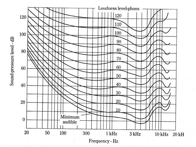

Μιχάλη, αναφέρεσαι στο flat από άποψη dB ή flat για το αυτί μας;
Γιατί οι Fletcher και Munson απέδειξαν ότι αυτά τα δύο δεν είναι το ίδιο.

Γιατί εγώ στα Fletcher-Munson curves βλέπω ότι όντως ένας ήχος 100dB@10kHz θα μας ακούγεται αρκετά δυνατότερος από έναν ήχο 100dB@500Hz...
Kοινώς, στα αυτιά μας, θα "τσιρίζει" παρ'όλο που θα είναι flat.

Μιχάλη ξέχνα λίγο το πιατίνι γιατί σε μπερδέυει. Στην θέση του βάλε ένα cd με συχνότητες. Οι συχνότητες είναι... συχνότητες και οι εντάσεις... εντάσεις. Αν σου τρυπάει το αυτί μια συγκεκριμένη συχνότητα, το αποτέλεσμα είναι ίδιο από όποιο ηχείο κι αν προέρχεται.
Η απάντηση στο ερώτημά σου είναι πολύ απλή και δόθηκε ήδη από τον Κώστα τον Φου ο οποίος παρέθεσε τις καμπύλες ακουστότητας. Οι καμπύλες ακουστότητας επί της ουσίας δείχνουν πως πρέπει να μεταβάλλεται η ένταση του ήχου αναλόγως της συχνότητας, έτσι ώστε το αυτί να αντιλαμβάνεται την ίδια ένταση σε όλο το φάσμα. Δηλαδή αν ένα ηχείο παίζει έτσι (όπως αυτή η καμπύλη), το αυτί σου ακούει, δηλαδή "μετράει", flat.
Αν την κάνεις flat, φαντάζεσαι τι θα ακούς?
Got it? :cool_4:
Όχι ρε, ανάποδα το πήγες... :cool_11:
Αν το βάλεις flat ακούς όπως η καμπύλη (κι ακόμα χειρότερα αν το φτιάξεις όπως την καμπύλη!).
Ανάποδα πρέπει να το φτιάξεις για να το αντιλαμβάνεται flat το αυτί. :cool_4:

Κώστα έχεις δίκιο για τις καμπύλες ακουστότητας, αλλά τo περίεργο στην ιστορία είναι ότι με "τέτοιο" target responce curve η απόκριση που παίρνω είναι εντελώς "flat" στην αρχική μέτρηση, κατά την άνοδο των επί μέρους συχνοτικών bars μέχρι να σταθεροποιηθούν στην τελική τους θέση.
Κάτι ανάλογο έστησα και στον Νίκο, και είδε το φαινόμενο στο οποίο αναφαίρομαι. Φτιάχνω "περίεργη" καμπύλη ώστε η αρχικές μετρήσεις να είναι "FLAT"....
Πάρτο αλλιώς.
Το κουμπί loudness φτιάχνει αυτήν την καμπύλη που ανέβασες (βάζει μπάσα, βγάζει λίγα μεσαία κλπ).
