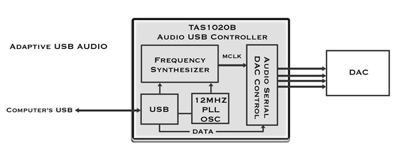

Now on to the fun part, the syncronization modes. In all casses the data from the bus goes into a buffer and gets clocked out by a clock, how that clock is generated and how it interacts with the bus is the differences between the modes.
Synchronous: in this mode the readout clock is directly derrived from the 1KHz frame rate. There is a PLL that takes in the start of frame signal and genrates a clock. Using this scheme its rather difficult to generate 44.1, but very easy to generate 48KHz. This is a primary reason why many early USB audio devices only supports 48KHz, they used this mode. As you can guess this mode is very susceptible to jitter on the bus, pretty much anything that causes the output from the host to be jittered (PS noise, vibrations, interference etc) AND things that can cause jitter on the interconnect (interference, reflections, ground noise etc) will wind up with jitter on the readout clock. This is a VERY poor mode to use for decent quality audio.
Adaptive: in this mode the clock comes from a separate clock generator (usually implemented as a PLL referenced by a crystal oscillator) that can have its frequency adjusted in small increments over a wide range. A control circuit (either hardware or firmware running on an embedded processor) measures the average rate of the DATA coming over the bus and adjusts the clock to match that. Since the clock is not directly derived from a bus signal it is far less sensitive to bus jitter than synchronous mode, but what is going on on the bus still can effect it. Its still generated by a PLL that takes its control from the circuits that see the jitter on the bus. Its a lot better than synchronous mode, but still not perfect by a long shot. This is the mode that MOST USB audio devices use today.

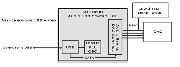

Asynchronous: in this mode an external clock is used to clock the data out of the buffer and a feedback stream is setup to tell the host how fast to send the data. A control circuit monitors the status of the buffer and tells the host to speed up if the buffer is getting too empty or slow daown if its getting too full. Note this is still isochronous, the host is continuousley sending samples, there is no "per packet handshake" going on. Since the readout clock is not dependant on anything going on with the bus, it can be fed directly from a low jitter oscillator, no PLL need apply. This mode can be made to be VERY insensitive to bus jitter.
Ορίστε κι ένα σχηματάκι με το adaptive mode που χρησιμοποιούν οι περισσότερες usb audio υλοποιήσεις και το asynch mode που θα ήθελαν να μπορούν να χρησιμοποιήσουν:
Oυσιαστικά, η μόνη περίπτωση που μπορεί το καλώδιο να κάνει κάποια διαφορά είναι σε υλοποιήσεις που βασίζονται στο data stream που έρχεται από το καλώδιο για να βγάζουν το clock. Αλλά αυτές εκ των προτέρων είναι λάθος υλοποιήσεις (στο USB receiver κομμάτι πάντα, στο D/A μπορεί να είναι άριστα). Σε τέτοια περίπτωση καλύτερα να επενδύσεις τα χρήματά σου σε αλλαγή του USB DAC ή του USB receiver μόνο, ανάλογα με την περίπτωση, με κάποιο σοβαρό, παρά σε "καλύτερο" (= με ferrite clamps που στοιχίζουν μισό ευρώ ο ένας και στους χρεώνουν x200) USB καλώδιο.

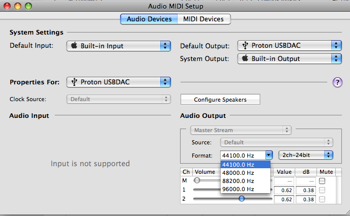

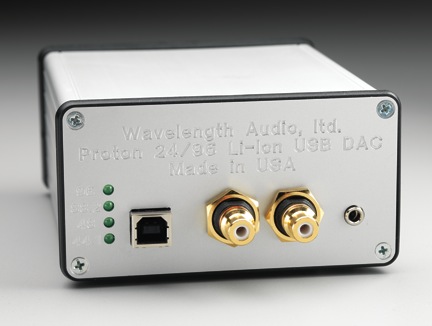

Wavelength Audio Proton Asynchronous USB DAC Review @ ComputerAudiophile
Μεταξύ άλλων:
Current DACs using similar Asynchronous implementations are the Ayre QB-9, which uses code licensed from Wavelength Audio, and the USB products from dCS. My guess as to why more manufacturers are not using Asynchronous USB is that the learning curve is very steep and it takes someone with the knowhow of Gordon Rankin or a company like dCS to bring this type of product to market.
