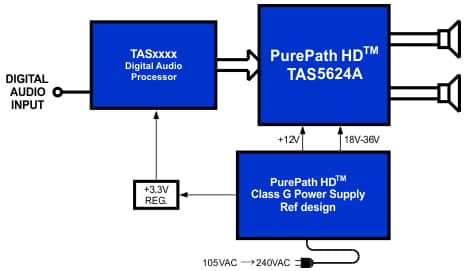

Και έχουν γίνει τόσο οικονομικοί οι class - D (αυτός του 200 XD είναι stereo) , που δεν βαριέσαι βάλε έναν ίδιο και στο tweeter. :rolleyes: - (δεν το λέω υποτιμητικά)
"The signals from the analogue audio input are scanned in 24-bit at 192 kHz by a Burr-Brown PCM1804 digital-to-analogue converter (bottom left in photo below). The signals from the S/PDIF are interfaced by a Cirrus Logic CS8416 chip (24-bit at 192 kHz, on the other side of the circuit).
Just to the right of the PCM1804 is the Texas Instruments TM4C1236 micro controller.
To the left, above the PCM1804 and TM4C1236 circuits, you can see the Analog Devices ADAU1451 digital signal processor (DSP), which takes care of the two filtering channel signals (low-mid, high) as well as the correction of the bass according to the potentiometer on the control panel. :wink:
The digital signals are then converted, not in analogue, but in PWM (Pulse Width Modulation), allowing them to directly get at the Texas Instruments TAS5624A switching amplifier.
Part of the signal is sent to the woofer, the other part to the tweeter, via filters made of inductors and capacitors to smooth out the analogue signals"
http://www.ti.com/product/TAS5624A
