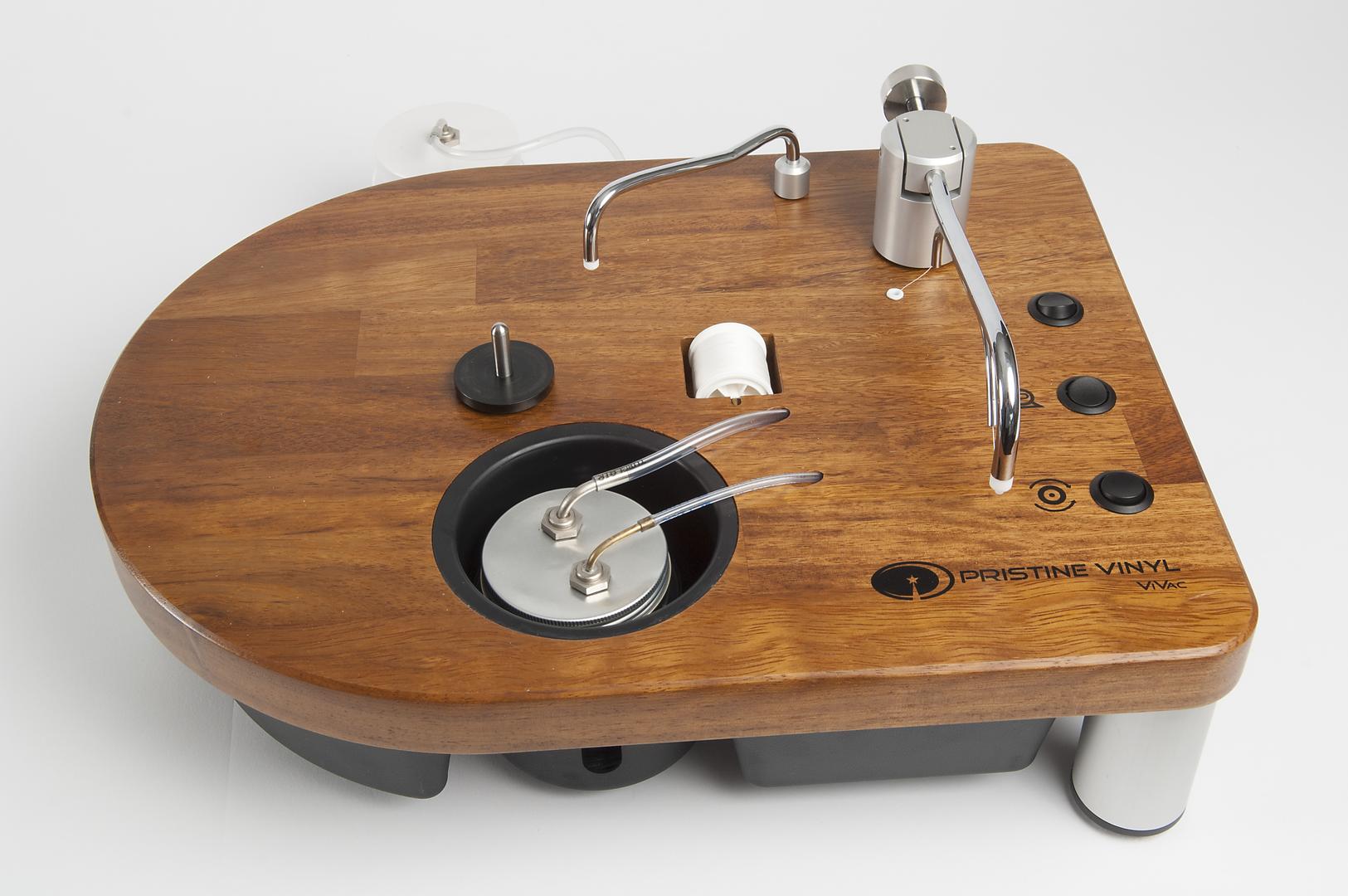

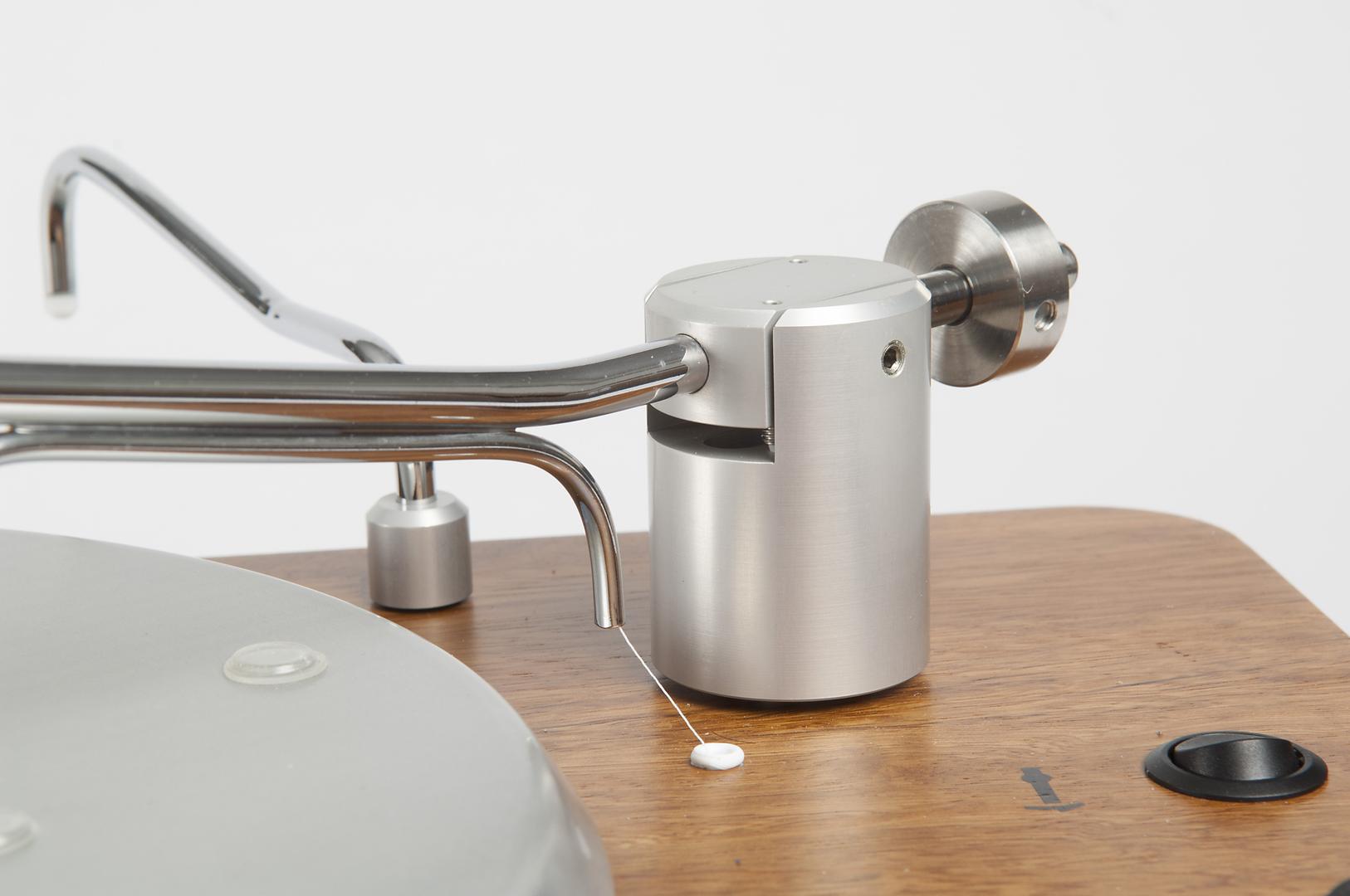

- μία ματιά στά ακριβά . . .
PRISTINE VINYL VIVAC RCS2 RECORD CLEANING MACHINE
Bringing record cleaning into the listening room is a good thing
The clues to the pros and cons of a Record Cleaning Machine are lodged in the name. The record cleaner part is increasingly vitally important, because as people buy up ‘mint’ albums from eBay (which turn out to be nothing of the sort) and from second-hand dealers at ever-increasing costs, a record cleaner does much to turn the clock back, making that LP sound as best it can. On the other hand, the ‘machine’ part means most record cleaners are big, noisy cubes that should be housed in a garage or a machine shop, and definitely not a listening room.
The Pristine Vinyl ViVac cleaner goes some way to address the needs of the home user, by making the cleaner small enough, good looking enough, and quiet enough to make its way into the listening room. OK, so in use it vibrates and hums a little, so no listening to a record while you are cleaning another, but turn the Pristine off and it’s smaller than most record decks, and represents just another shelf in your system. By bringing the cleaner into the listening room, and by not making it sound like you are trying to start a tractor with a howitzer, it means you are more likely to clean a record. By making the process quick (when you get adept and the ViVac is primed and ready to go, cleaning takes about a minute and change per side), it means you are likely to clean more records, too. The logic is if it’s in the room where the records live and where the records are played, it will get used, but using your record cleaning machine means dragging a bunch of records into the basement like some kind of hipster dungeon master, you’ll give up the cleaning schedule after a few goes . . .
http://www.hifiplus.com/articles/pristine-vinyl-vivac-rcs2-record-cleaning-machine/
Pristine Vinyl's ViVac RCS2 Record Cleaning Machine

..ωραιο!! Το πλυντηριο δε μπορω να το αγορασω spock, εχω αλλωστε, το βουρτσακι που μου αρεσε ομως μπορω..
Aπο θορυβο πως παει;
Απο τιμη;
Ν
Νίκος Τεγόπουλος
..2.000£; φτηνο φτηνο! Παντως ειναι τελειως αθορυβο..
