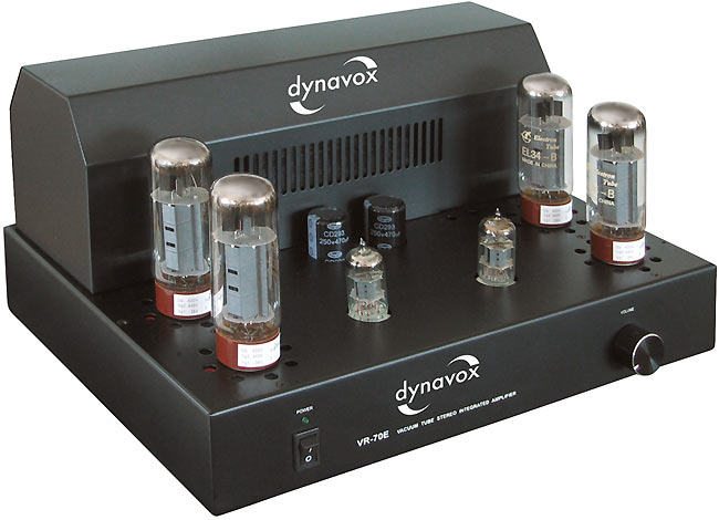

Επιγραμματικα τι αναβαθμιση μπορει να δεχτει;
Τελειως επιγραμματικα : Τα παντα
Για αρχη αυτα απο http://www.hifi-forum.de/viewthread-111-558.html
Hello,
Here are some of the (cheap and simple) modifications I did to my Dynavox VR-70E.
My general experience has been that capacitors play a big role in the overall sound. The standard capacitors in this amp are bad sounding cheap junk. That said, all the other parts also play a big role in the soundquality
1) Remove input capacitors = first capacitor of each channel after the volume poti. Replace it with a straight wire: Improvement: big! Much deeper bass and clearer sound. These caps have no function but to filter out dc from the cd-player, but the output stage of your cd-player has output caps with the same function, so they really do nothing except mess up your music!
2) Replace coupling capacitors (0.47µF) with high quality types, best are paper-in-oil (you can find them cheap if you search a little on ebay): improvement: huge: much clearer sound, deeper and more controlled basses (even with the same value replacement). There's no real use in replacing with higher values.
3) Replace decoupling capacitors with high quality types, best are paper-in-oil
4) Replace the lousy standard Chinese EL34 with =SED= El34: biggggggg improvement: terrible floppy bass is gone, sound has much more air etcetera
5) Replace the Chinese 6f2 with other type ECF82 = 6U8A. I found the standard chinese not so bad, but a little laid-back midrange. I've tried several makes of ECF82 and EI are in my opinion the best: airy, flowing sound + you can see their construction is top quality
6) Remove the lid (Haube) that covers the transformers: this opens up the sound (the cover shields them magnetically, which has certain advantages, but also results in a more 'closed' sound)
7) Replace the standard diodes (needless to say they are junk) with (Ultra) fast soft recovery diodes. I just did this an hour ago and am surprised with the result: much more airy sound and more controlles basses, music comes more in the room instead of staying in the speakers, huge authority!!!
Future modifications:
- replacing the very very crap volumepoti with a stepped attenuator with 1% tolerance RN military spec metalfilm resistors: this should give a much better imaging (I'm really not happy at all with the imaging at the moment, no pinpoint at all!!! + much clearer sound). A good quality carbon pot like Alps is also good, but imo 20k is a difficult value to find
-replacing the cheap elkos in the power supply with paper-in-oil should also be a big step forwards
-Maybe replacing all the resistors with high quality carbon types (allen bradley). I haven't disected the standard resistors yet, but am pretty sure they are cheap metalfilm type. Expected improvement: warmer, less sharp sound
- replacing all the capacitors with better quality types
My opinion about this amp is that the most expensive parts (= power transfomer and outputtransformers) are of good quality, especially considering the ridiculous price, and I like the schematic. If you spend a little time and change the components with higher quality types (what the amp comes with is really cheap junk and this literally messes up your music) you can bring it to a MUCH higher level + it's a wonderful experience to solder, replace and then hear the improvement!!!
I'm not talking about marginal differences, each of these tweaks is clearly audible for ANYONE. Try it and thank me later!!!
Don't hesitate to ask if you have any questions or if you'ld like me to mail you a copy of the schematic.
