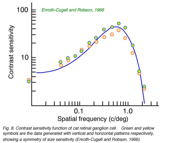

Απάντηση: Contrast ratio (CR)... Ποια η αλήθεια και ποια η μπλόφα;
Και για να έχω την χαρά να γελάσετε λίγο ακόμα φίλε Κώστα.
At any given moment, for example, scientists say the retina can only perceive a contrast ratio of about 100:1, although continual movement and refocusing by the iris increases this substantially.
http://www.theglobeandmail.com/serv...oundernov28/BNStory/Technology/Troubleshooter
1. Dynamic rangeThe retina has a static contrast ratio of around 100:1 (about 6 1/2 stops). As soon as the eye moves (saccades) it re-adjusts its exposure both chemically and by adjusting the iris. Initial dark adaptation takes place in approximately four seconds[citation needed] of profound, uninterrupted darkness; full adaptation through adjustments in retinal chemistry (the Purkinje effect) are mostly complete in thirty minutes[citation needed]. Hence, a dynamic contrast ratio of about 1,000,000:1 (about 20 stops) is possible. The process is nonlinear and multifaceted, so an interruption by light merely starts the adaptation process over again. Full adaptation is dependent on good blood flow; thus dark adaptation may be hampered by poor circulation, and vasoconstrictors like alcohol or tobacco.
http://wapedia.mobi/en/Human_eye
Όταν η προσαρμογή του οφθαλμού χρειάζεται 30 λεπτά, για να αξιοποιηθή μια μεγάλη μεταβολή και υπάρχει εναλλαγή σκηνών σε πολυ μικρότερο χρονικό διάστημα, το δυναμικό εύρος δεν έχει πρακτικά μεγάλο νόημα.
