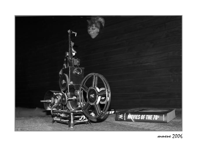

Και ένα μικρό τέστ. Αυτή η μηχανή προβολής τι μάρκα είναι, τι φορμά και τι έτος παραγωγής;
Για να μην ξεχνάμε, πως το home cinema δεν ξεκίνησε με τον βιντεοπροβολέα.
535
Απάντηση: Contrast ratio (CR)... Ποια η αλήθεια και ποια η μπλόφα;
Και για να το πάρει το ποτάμι.
The Pathé-Baby projector, unveiled to the public at an exhibition in October 1922, proved to be revolutionary in its field. Small, compact and easy to use, it was solidly constructed (by Etablissements Continsouza, a Pathé subsidiary) and showed films contained in enclosed ten metre cassettes. After the leader had been placed in the gate channel, the film was threaded automatically on to the bobbin in the take-up chamber. The operator turned a well-balanced crank handle (two turns per second) and at the end of the film, a highly geared little handle enabled him to rewind the film speedily into the cassette. The running time of each film was cunningly extended by the incorporation of "notched" titles: a notch cut in the edge of the film triggered a mechanism which withdrew the transport claw just long enough to enable the audience to read the title, which was printed on a single frame. Static scenes were treated in the same way so that some of the early documentary ten metre reels run for as long as three or four minutes. A resistance was built into the base of the projector to enable the 6 volt 6 watt bulb to be powered from a 110 volt mains supply. A quite reasonably illuminated picture about two feet wide, with good definition, could be obtained at a short distance or "throw" - ideal for using the outfit in a room of modest size.
http://www.cinerdistan.co.uk/history.htm
Αν θές λοιπόν φίλε Κώστα, όταν βρεθούμε από κοντά κουβεντιάζουμε καλύτερα γιατί πράγματι είναι, ΚΑΘΕ ΦΕΤΟΣ ΚΑΙ ΧΕΙΡΟΤΕΡΑ, αφού σου γνωρίσω τον πρώτο μου προβολέα.
