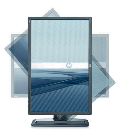

HP ZR24W review
So who is the ZR24W for? Mostly discerning users that like a good picture and enjoy some gaming as well. Graphic artists and photographers might enjoy the HP ZR24W, too, and the price is very attractive. It doesn't beat the Dell U2410 or NEC EA231WMi but it's certainly an alternative if you're looking for a reasonably priced IPS/VA monitor. I'm a bit disappointed with the weak black levels, though.
