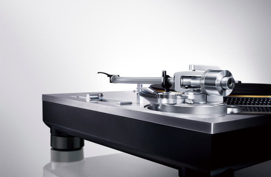

The remaining influencer on a playback setup’s sound is of course the tonearm. The ’arm on the Technics is integral. In principle, it can be removed and replaced, but this is not the easy task it is on turntables with an ’arm board cut to accommodate almost any tonearm in the usual way.
My main issue with the ’arm on the SL-1200G was bass performance. With no damping and conventional moment-of-inertia pattern, the tonearm allowed a certain lower-octave “bloom” followed by deepest bass roll-out from undamped ’arm/cartridge resonance. This was not a huge problem musically for most material, but once one has become accustomed to hearing correct low end, one does notice the difference. To help with bass correction one is “spoiled,” as it were, by Townshend trough damping, or the Well Tempered tonearm, or especially the “anisotropic” Moerch DP-8 ’arm (which has much larger horizontal than vertical moment of inertia). However, one also gets used to the aformentioned bloom, which is after all a feature of most vinyl playback systems, and a characteristic that sits well with music—it sounds something like a warm hall. But it is really not quite right here.
In any case, the built-in ’arm does separate the overall performance from the state of the artsiest art, at least in my impression. Installing a Townshend front-end trough would be tempting, and this could be done without undertaking to modify the turntable structurally. The trough appears to be a little tricky to fit it in, but I think it could be done, albeit at some sacrifice of the turntable’s elegant appearance. The trough pretty much bypasses the character of an ’arm itself and makes the bass excellent, besides improving the rest of the audible frequencies. And one can hope that Technics might offer a version of the turntable sans ’arm.
On the plus side, the Technics tonearm is easy to set up, and its adjustments are completely stable. My experience is that the correct amount of anti-skating force was less than the built-in setting dialed up based on tracking force. Running the Shure for instance at 0.5 grams, what I considered to be correct anti-skating involved setting that dial to 0.8. But of course you can choose for yourself since this is user-selectable and independent of the tracking force. As noted earlier, I suggest not messing with the factory-set operating modes (though you could change these with a screwdriver through holes in the turntable).

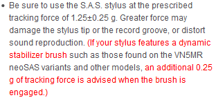

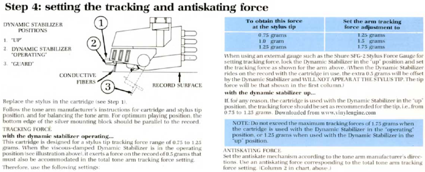

Καλημέρα εχω ένα 1200 mkii με μια shure v15iv με jico sas βελονα .Θελω να μαθω με κατεβασμενο το βουρτσακι το βαρος το αντιστοιχο VTA και το VTF.Ευχαριστω
1.110
1.173
Ουσιαστικά πρέπει να προσθέσεις μισό γραμμάριο με κατεβασμένο το stabilizer.
Και θεωρητικά αφού το tracking force της Jico είναι 1.25 (+/-0.25) δεν αλλάζεις τίποτα από τις προδιαγραφές της Shure.
Από το manual της Shure
Από την Jico
