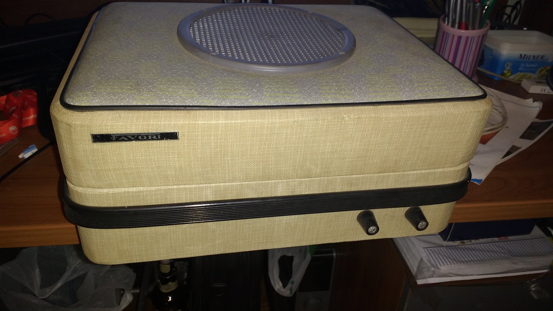

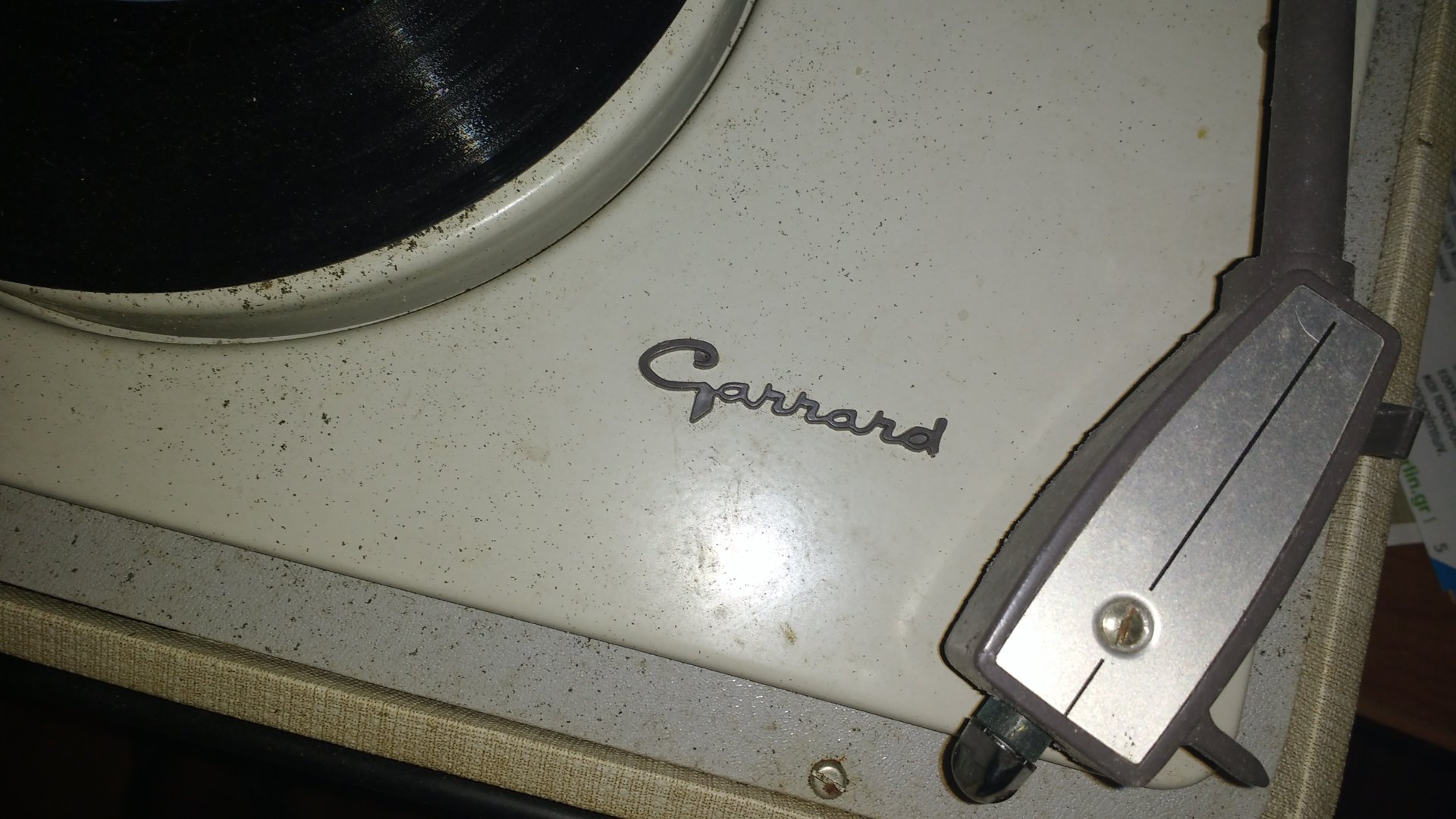

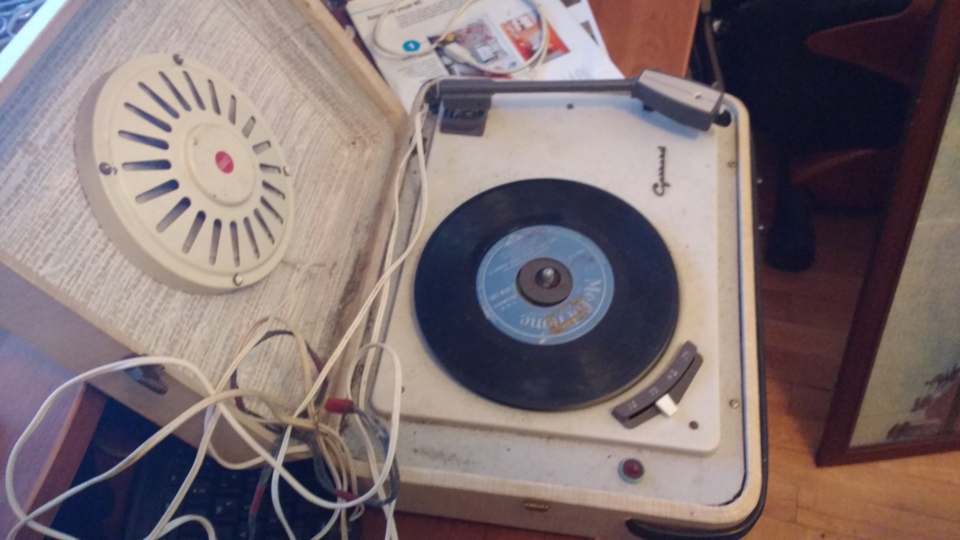

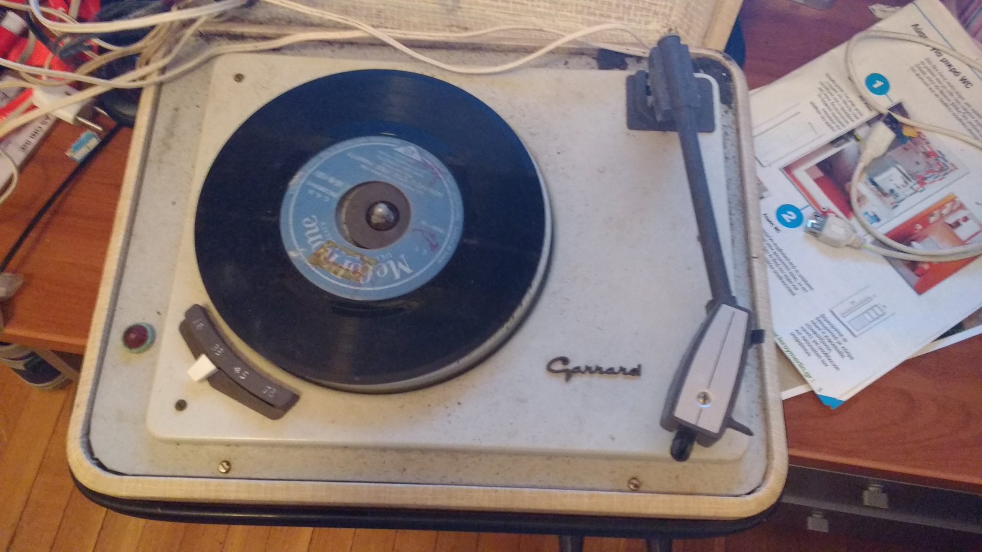

Καλησπέρα σε όλους,
Πρόσφατα βρήκα σε μία αποθήκη ένα πολύ συμπαθητικό φορητό πικαπ με το οποίο θεωρώ ότι αξίζει να ασχοληθώ. Θα εκτιμούσα οποιαδήποτε πληροφορία, βοήθεια σχετικά με το πικαπ, απο κάποιον έμπειρο.
Ευχαριστώ

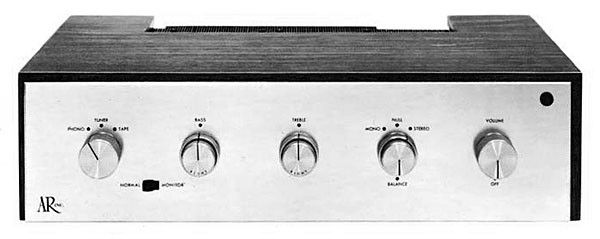

The Acoustic Research integrated amplifier
The first time we saw an AR amplifier (at a Hi-Fi Show), we were struck by its bland, almost antiseptic appearance. Amidst all those other audio products that looked as though they had been high-styled for Madame's boudoir, the unadorned simplicity of the AR amplifier made it stand out like an Eames chair at Williamsburg.
Listening
We tested the AR amplifier with three varieties of loudspeaker: an all-dynamic system (Dynaco A-25), a dynamic/electrostatic system (Janszen Z-600), and a full-range electrostatic (the KLH Nine). On all three, the sound was very clean and lucid, but not without some degree of coloration.
Transparency was very good despite a barely detectable hint of graininess, crescendos were handled very cleanly and solidly, overload recovery was extremely fast (unless the protective thermal breakers let go, in which case it took several seconds for the dead channel to come on again), and when mild clipping occurred, the resulting clicks were judged relatively innocuous
Conclusions
Whether or not the particular sound of the AR amplifier is worth your consideration depends on the loudspeakers you use it with, the way they behave in your listening room, and your own personal taste for reproduced sound. For example, we have encountered cases where no amount of careful placement of loudspeakers could make them sound anything but thin, and it was not always the fault of the speakers, either. Tweeter balance controls are rarely able to correct a condition like this, and very few tone controls can do it either. But the peculiar behaviour of the AR amplifier did solve the problem very nicely in two such instances.
