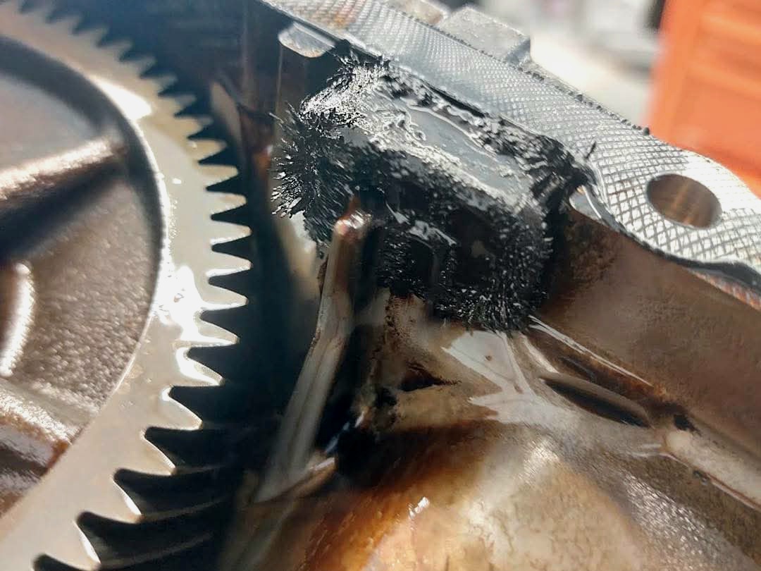

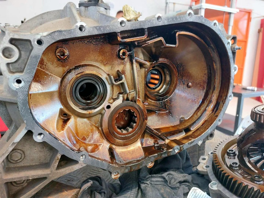

EV Clinic.
Škoda Enyaq with 165,000 km suffered oil leakage from the e-motor differential at the driveshaft seal, which led to the remaining oil burning off in the gearbox and damaging the bearings. The e-motor is produced by Siemens Valeo (same supplier as in the Mercedes EQS), and this is one of the first samples we have seen.
The Enyaq was regularly serviced, but it is unclear whether the bearing failed first, creating an air gap at the seal that caused the oil to leak out, or if the oil leak occurred first and then damaged the bearing. Considering we have previously repaired a Tesla LDU (286 kW) that had run completely without oil for 160,000 km (because a Tesla technician forgot to refill it), it is likely that the bearing may have failed first.
What is concerning is that the monopoly practice of mandatory scheduled servicing to maintain warranty is completely misguided. Tesla, for example, has no mandatory services and not even a service booklet. Meanwhile, traditional OEMs force customers to spend around €800 every 20,000 km on service visits, where they replace brake fluid and coolant unnecessarily, adding avoidable CO₂ footprint and environmental waste—just to keep customers returning. Yet, the most critical item—oil replacement in the e-motor differential—is missing from every EU manufacturer’s maintenance schedule. It is absurd that, due to one liter of oil, manufacturers can charge up to €10,000 for drivetrain damage once the vehicle is out of warranty.

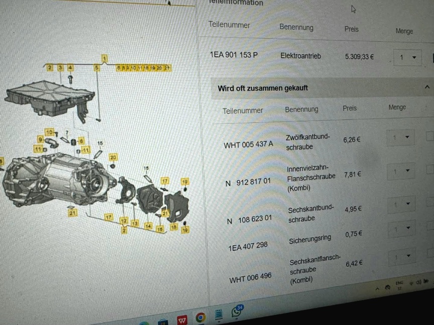

Even worse, VAG (VW Group) once again designs e-motors with bearing dimensions that are commercially unavailable—produced only for this transmission type. This unsustainable design approach, seen repeatedly in EU manufacturing, reduces repairability to zero and effectively forces scrapping of “rare earth material” components just because of six bearings intentionally made unavailable, even from the bearing manufacturer.
Since these e-motors are both expensive and widespread across the VAG lineup, we expect to see more inquiries for remanufacturing.
Catalog: 1EA907121C, 1EA901153P, Valeo Siemens
Failure: Milling / buzzing noise
OEM Price: €5,300 + tax
EVC: €2,500 + tax

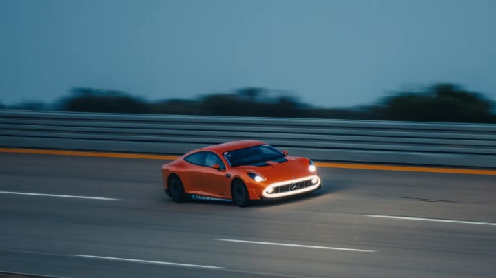

Από το διαχειριστή της ομάδας ηλεκτροκίνησης στο FB.
"Το ηλεκτρικό πρωτότυπο Mercedes AMG GT XX διένυσε σχεδόν 5.5 χιλιάδες χιλιόμετρα σε μία ημέρα, κάτι που δίνει μέση ωριαία ταχύτητα σχεδόν 230 km/h μαζί με τις στάσεις φόρτισης. Ναι σωστά διαβάσατε, πήγαινε με 300 km/h και σταματούσαν για φόρτιση με μέση ισχύ 850 kW.
Το πιο εντυπωσιακό είναι ότι δεν τερμάτισε στις 24 ώρες, αλλά συνέχισε μέχρι να καλύψει σε απόσταση "την περίμετρο της γης". 40 χιλιάδες χιλιόμετρα σε επτάμιση μέρες. Μια μέση ωριαία ταχύτητα στα 220 km/h μαζί με τις φορτίσεις.
Φαντάζεστε τι ξύλο έφαγε το κινητήριο σύστημα (μοτέρ, μπαταρία, ινβέρτερ) καθώς και το σύστημα ψύξης, όλες αυτές τις ημέρες αδιάκοπα. Ζόρι έφαγαν και οι οδηγοί, μια ομάδα 17 ατόμων που άλλαζαν βάρδιες ανά 2 ώρες περίπου.
Αυτά τα ωραία! Και είμαστε ακόμα στην αρχή. Αν διαβάζαμε την ίδια ιστορία 5-6 χρόνια πριν, μάλλον θα το θεωρούσαμε επιστημονική φαντασία."
symos
You're not worthy!
4.268
9.316
Σιγά τα καλσόν.
Θα μας έκανε εντύπωση δηλαδή (πόσο μάλλον να το θεωρούσαμε επιστημονική φαντασία) αν πριν 5-6 χρόνια ένα Model S έκανε κάτι αντίστοιχο;
Σιγά το κατόρθωμα να γυρίζει ένα αυτοκίνητο γύρω γύρω σε μια πίστα, να σταματάει για ανεφοδιασμό και μετά να ξεκινάει ξανά.
ΟΚ, ναι, καταπόνηση από τη συνεχόμενη λειτουργία (μόνο όσον αφορά κάποια συστήματα, γιατί άλλα όπως τα μοτέρ "ξεκουράζονται" κατά τη φόρτιση) αλλά αυτό έλειπε μετά από 130 χρόνια που φτιάχνουμε αυτοκίνητα να ήταν δύσκολο να φτιάξουμε ένα που να λειτουργεί μερικές μέρες χωρίς διακοπή.
Ούτε το "μα είναι ηλεκτρικό" είναι επιχείρημα. Ένα air condition έχουν για την ψύξη. Στο σπίτι μας που δουλεύουν 4 μήνες συνεχόμενα το καλοκαίρι τα air condition το θεωρεί κανείς επιστημονική φαντασία; Κατά τα άλλα τι να χαλάσει και γιατί;

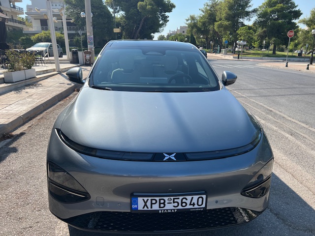

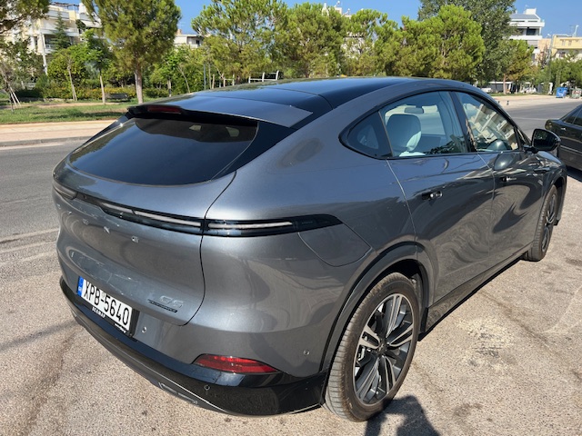

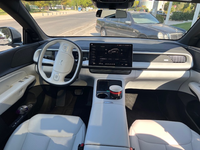

XPENG P7.
Cd 0.201
75kWh LFP, 92kWh NMC
Dimensions: 5017/1970/1427
800v, 5C Charging, 10% - 80% σε 10' (525χλμ).
RWD (362hp), AWD (586hp), 0-100km/h 3.7sec
Computing power of 2250 TOPS (Trillion Operations per Second). To Tesla HW4 είναι 500 ΤΟPS. H XPENG είναι η μοναδική από Κίνα με Vision Only ADAS και Self Driving System. Το P7 είναι το πρώτο XPENG που φεύγει από την παραγωγή και πάει στο garage μόνο του.
spylab
14.764
37.368
Το εχει long term δοκιμη φιλος, που περιμενει να παρει το G-9.
Απιστευτο απο μεσα, που εχει σημασια .
Παρα πολυ γρηγορο, ηδη στο economy!
