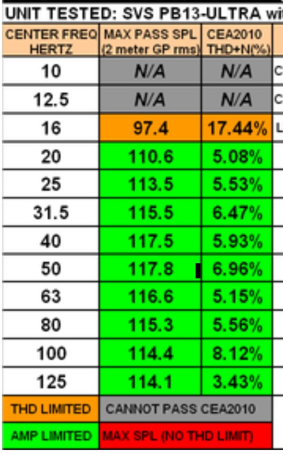

Σε συμβουλεύω να μην αγοράσεις αν δεν δεις μέτρηση.

Θα τους ζητήσω μετρήσεις και βλέπουμε.

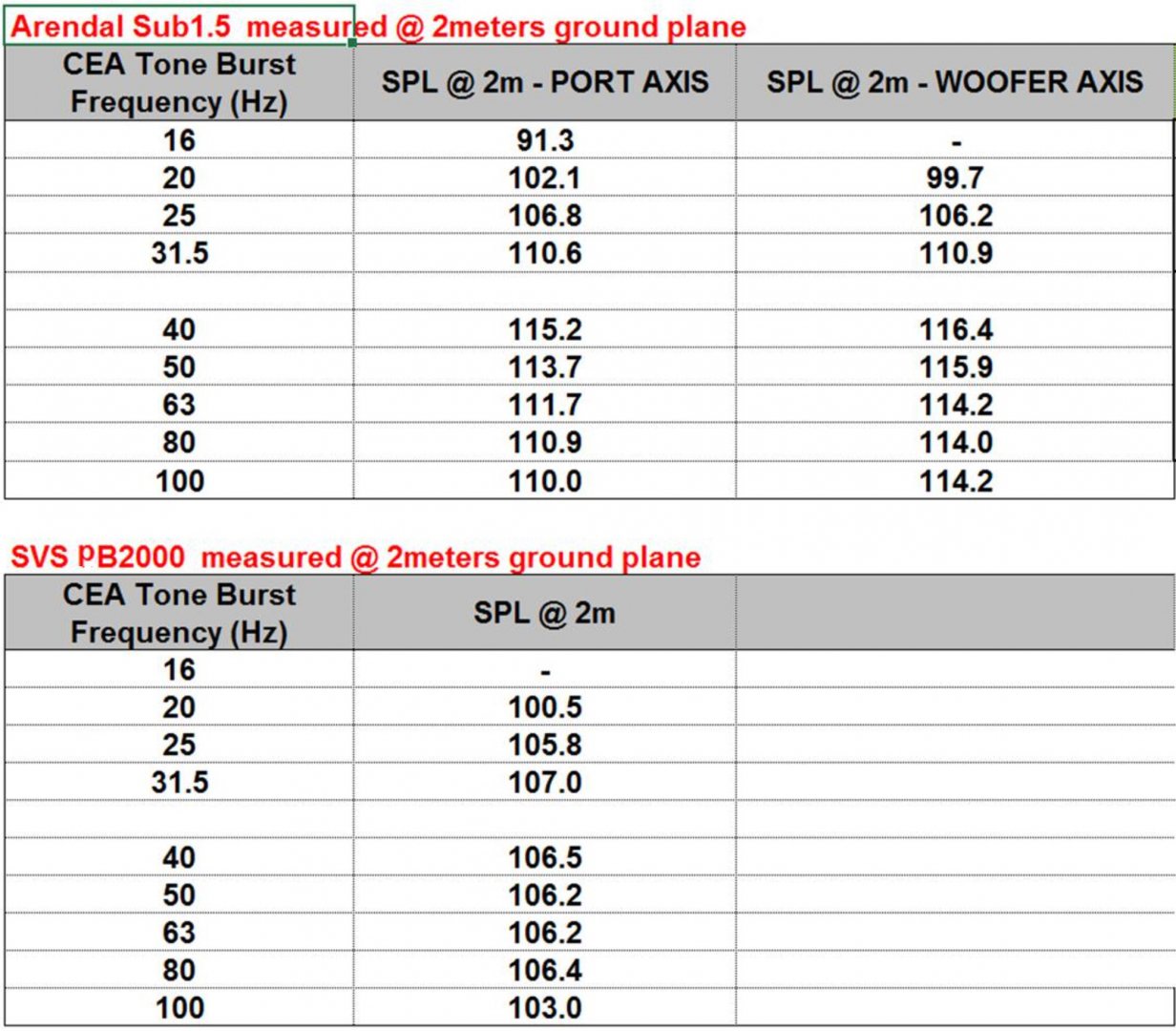

και συνεχίζουμε με την άμεση ανταπόκριση
Η ερωτήσεις ήταν σχετικά με τον αν υπάρχουν μετρήσεις cea 2010
Και αν λόγο του ιδιαίτερου σχεδιασμού είναι πιο δύσκολα στην σωστή τοποθέτηση στο χώρο
και εδώ η απάντηση
Hello Nasos,
That is very good to hear, we certainly appreciate it!
Regarding CEA 2010 measurements, that is a hot topic. Mostly we have not given out such, because a lot of the measurements out there a "flawed". The CEA2010 does not give a good enough standard of measurement, and some of the industry manufacturer use this obviously to their advantage - that is why in some cases you will see individual persons making their own measurements of subwoofers from several manufacturer only to find some of them differ a lot from the claimed measurements.
Now however we have done a lot of measurements on our own obviously, and I am willing to share with you the measurement between our 1723 Subwoofer 1.5 compared to a pretty well known SVS subwoofer, the PB-2000. (the image says SVS SB2000, but its just a writing error). There is no measurement at 16Hz for the SVS because the amplifier couldn't manage high level bursts at that frequency (it literally shut down). Now as you see the SVS is not that far behind in the deepest bass (because thats where their focus has always been), but it is a complete walk-over from 30 Hz and above. Keep in mind 3dB extra is the equivalent of double power or two drivers instead of one. At 40-50Hz its nearly 10dB difference, which is the equivalent of going from 500W to more than 2000W on the amp.
The biggest difference between Arendal Sound and SVS though, is the way our subs deliver dynamic impact and "slam", they hit considerably harder and faster. You get more of a chest punch, and a sub that much easier integrates with the speakers for music playback.
If you are interested, here are also our frequency responses for all products. https://www.arendalsound.com/graphs-data/
Regarding comments that say the dual driver subwoofers are more difficult to place than a normal subwoofer, I can guarantee the persons who claim that have never tried. In all our experimentation and as a importer and distributor of countless other brands with both single and dual driver configurations (through www.lsound.eu/www.lsound.no) it always is the case that dual versions couple better with the room for any placement. Keep in mind a subwoofer will spread the sound at more or less 360 degrees throughout its frequency range, especially valid in the deepest bass registers. But the pressurising of the room will depend on how many sources of sound there is and thus how they couple with it.
The easiest way to get good bass without any knowledge on placement and calibrations is simply using a single dual driver subwoofer and let the AVR do time alignment. For any setup with multiple subs it does require more effort and know how to get it sounding right, but it certainly has the highest potential of getting a very even bass response throughout the room and the frequency range. For your room though placing one sub in each 4 corners or dual driver subs in the front corners will most likely give you the optimal results.
Best regards,
