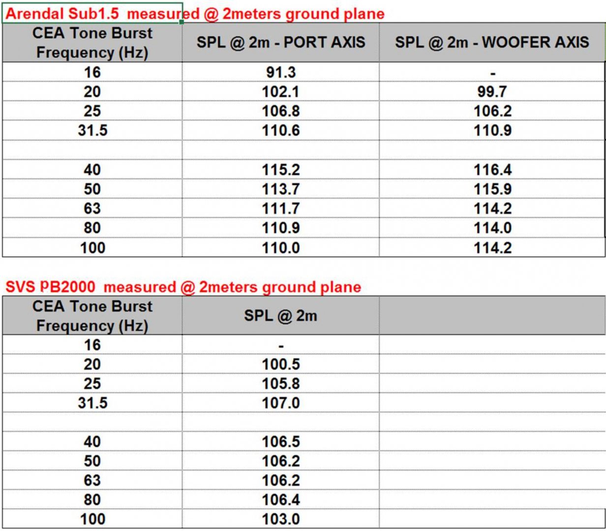

Ένα συγκριτικό μεταξύ svs sb4000 vs Arendal sub 2
ένα απόσπασμα
The 1723 has a significantly tighter bass with greater dynamics in the impacts, without losing its impact. SVS has plenty of punch it too, but it’s unable to stop and restart as fast, which inhibits the music a bit.
“SVS does not sound as dynamic, and does not nearly reach the same transient response as Arendal,” comments Geir.
SVS sounds straightforward when movies are on the menu. The spacecraft explosion in the Alien Covenant strikes deep into the spinal cord, but the shock wave does not feel as dynamic and “explosive” as the Arendal suben makes with its double basses.
There is no doubt that SVS has more levels from 20 hertz and downwards, but the gain is not as great as we had hoped. Arendal Sound has more pace up in frequency. The bass also feels cleaner, faster and tighter, with a more seamless transition to our main speakers (Focal Kanta).

Το εχω διαβασει αυτο το τελευταιο συγκριτικο και εγω αλλα ειναι λιγο γενικο και αοριστο βασιζομενο καθαρα σε υποκειμενικοτητες.

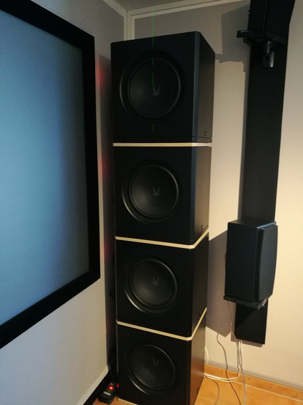

Εδώ και μία βδομάδα λοιπόν κάτοχος 2 χ Arendal sub 2. To pb 13 έφυγε.
Το ακουστικό αποτέλεσμα με δικαίωσε. Υπάρχει τεράστια διαφορά στο ηχητικό αποτέλεσμα προς το πολύ καλύτερο.
