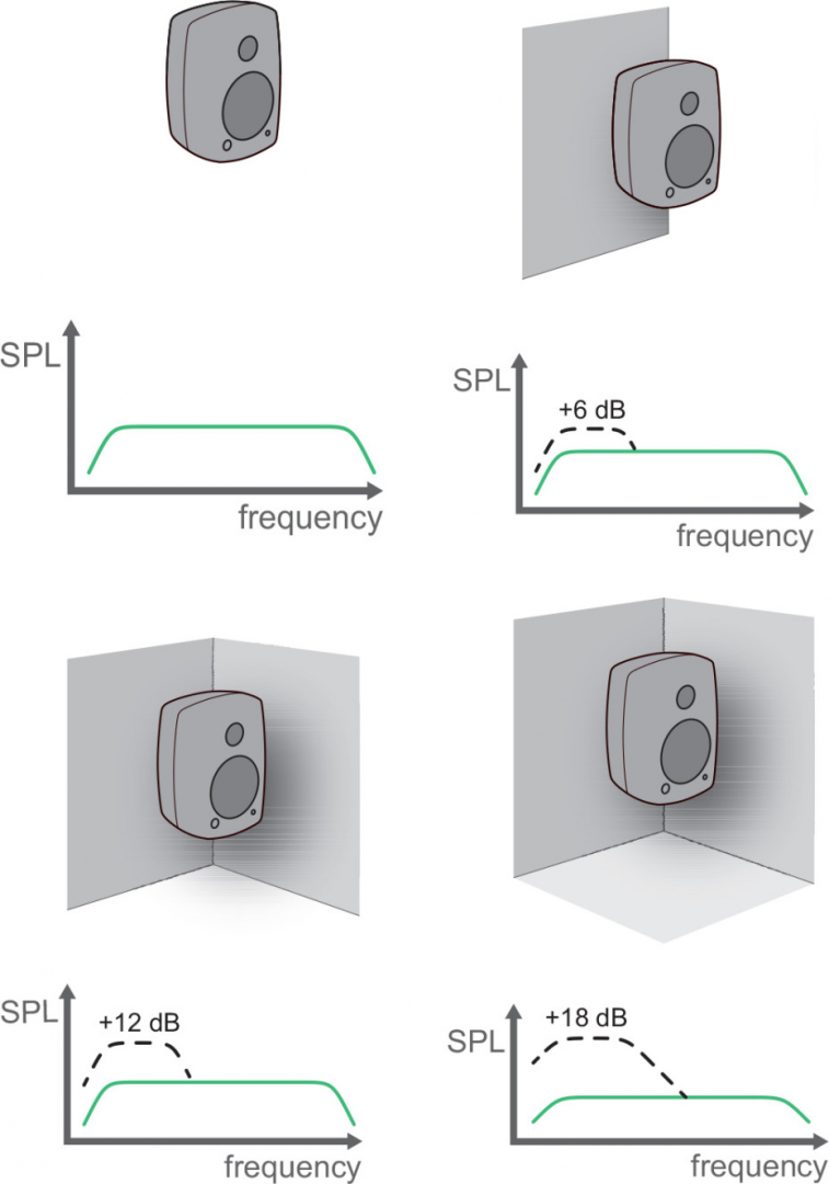

αντιδεοντολογική τοποθέτηση :p αλλά ποντάρεις στα 12db της γωνίας να φανταστώ
Ποιά 12; Δεν υπάρχουν 12. 3 είναι στον half space (πάτωμα), άλλα τρία από έναν πίσω τοίχο (quarter space) και άλλα 3 όταν είναι στην τρίεδρη γωνία.
από την genelec το είχα δει
Θυμάμαι τα είχε γράψει και ο Κώστας EAR, αλλά θυμάμαι και τα παρακάτω γραφήματα:
Let’s start out simple… one boundary (the floor) with a distance to the speaker set at 35 inches. Here’s the theoretical augmentation you can expect:
Notice approximately 3 dB of gain at the low frequencies from this one boundary, followed by some constructive and destructive interference starting about 80 Hz.
Now we'll add a second boundary and recalculate for the augmentation effect of two boundaries (for example the floor and the back wall), both 35 inches from the speaker:
Now you’ll see approximately 6dB of gain at the low frequencies due to these two boundaries, followed by some constructive and destructive interference. Also notice that this augmentation curve is starting to look worse.
Ok, let’s get real. Most of us will have three boundaries to worry about. The floor, the back wall and the side wall. Here’s the augmentation when the speaker is 35 inches away from each of the three room boundaries:
Yikes! We’ve got 9dB of bass augmentation, but 11dB of nastiness (deep null) thrown in there. Fortunately for us, it’s simple to remedy this problem. All we have to do is make those three distances as dissimilar as possible. I've found that a ratio of about 1: 1.625 : 2.375 works well for most full-range speakers. Like this: (20” to floor, 32.5 inches to back wall, and 47.5 inches to side wall. Ahhhhhh yes… now that’s a significant improvement over the 35", 35", 35" in the previous example.
