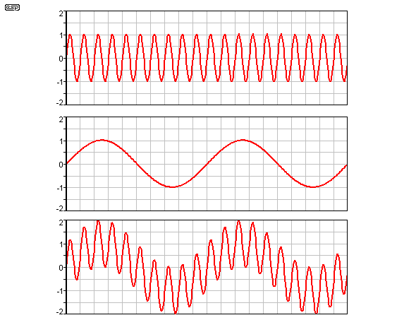

Για την ενεργή πολυενίσχυση του το είπα κι εγώ.
Κι έχω σοβαρό λόγο να το λέω από την στιγμή που μηχανάκια όπως τα Densen που έχω εγώ (που παρά τον ήχο τους,όλοι ξέρουμε τις ψιλοαδυναμίες τους στο χαμηλό),μεταμορφώνονται σε τέρατα λες και κάποιος τα τούρμπισε.
Παρακάτω παραθέτω ένα απόσπασμα από τον γέρο-Elliott που ίσως και να εξηγεί το γιατί.
If we assume that our 100 Watt amplifiers will be handling exactly the same peak amplitudes with typical program input, then we have a total of 200 Watts for the combined program material. So, where does the magic come into this? This amp combination will sound (and measure) as if it were 400 Watts - twice as much "effective" power as there is real power. For this to make sense, we need to back track a little.
Imagine a sine wave signal of 100Hz at an amplitude of 28V RMS. For an 8 ohm load, this equates to about 100W (98 actually). The same amplitude at 1000Hz will be exactly the same power. Now add the two signals together, in the same way that signals add together in music. We are interested only in the peak amplitude, the RMS value indicates that the power is only 3dB higher, but it is only when an oscilloscope is used that the true picture emerges.
We will now see a low-frequency waveform, with a higher frequency waveform superimposed - the high frequency signal will be riding up and down the path of the low frequency signal. If we were to perform a calculation (or simply measure the combined signal with an oscilloscope), we will see that the peak amplitude has doubled. The effective RMS value (most multimeters will get this wrong unless they are true RMS types) is 40 Volts, and this would imply 200W. Although this is the real RMS voltage, it totally underestimates the amplifier power needed to reproduce it cleanly. An oscilloscope shows 80V peak for the same waveform, so the amplifier must be capable of passing an 80V peak signal - a 400W amplifier.
To illustrate this point, Figure 2 shows two signals, each of 1 Unit peak amplitude. As can be seen, when the two are combined, the amplitude is much greater. The maximum peak amplitude is now 2 Units - double the peak voltage and four times the peak power of each signal individually. Power increases as the square of voltage, so twice the (peak) voltage is four times the power. Real ('RMS') power increases by 3dB or double the power, but this is a misleading figure and cannot be used. An oscilloscope is essential.
