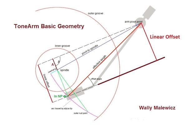

Updates and Corrections to Recent Technics SL-1000R Preview Story
Michael Fremer | Feb 21, 2018
In the recent story about the week I spent with Technics' new SL-1000R turntable, the difference between what's commonly referred to as an arm's "effective length" and how Technics uses the term in its literature led to some confusion and a series of conceptual errors on my part for which I take full responsibility . . .
. . . So out came the Acoustical Systems SMARTractor to measure the P2S distance and sure enough the arm's P2S distance, not its effective length was 239mm! The arm's true effective length was 254mm not 239mm. I was correct enough about that, but that led me to make some mistakes conceptual and otherwise . . .
. . . First, I thought this confirmed that Technics had made a serious error and that if I wanted the Löfgren A alignment I'd have to re-do the overhang using Wally's gauge, which is what i did and that's how I listened. However, had I left the overhang alone, as it was set up using the Technics gauge, that would have been correct, based on Technics' calculations though they don't reveal the source of their geometry. In any case, you can pretty much set up any arm using Baerwald, Löfgren, Stevenson or UNI-DIN and get different but acceptable results. Since the "null" points are based upon never kept standards as to where the lead in and lead out groove areas start and stop, there's definitely room for some "play"
Nonetheless, I apologize for making Technics look like its geometry was in error, when it was not. My conceptual error was not realizing that since the Technics overhang gauge is a head shell holder that duplicates the arm terminating collet, the overhang setting must be correct for whatever is their geometric calculation. Whether or not what I came up with resulted in a gross error or simply another but different solution is something about which I'm not yet certain. I've got an email in to Wally for his explanation . . .
